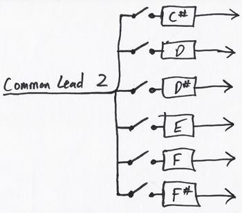

choklitlove
Joined: Dec 23, 2005 Posts: 144 Location: Indiana
Audio files: 17
Posted: Fri Mar 03, 2006 9:54 pm Post subject:
this might help me explain a little better.
when any of the keys connected to "Common Lead" 2 are pressed, all of the notes connected to "CL" 2 play. this shouldn't happen. does my problem make a little more sense now? |

toppobrillo
Joined: Dec 10, 2005 Posts: 766 Location: oakland, ca
Posted: Fri Mar 03, 2006 11:03 pm Post subject:
| wait so buss 3 keys work properly? |

toppobrillo
Posted: Wed Mar 08, 2006 9:54 pm Post subject:
all i can tell you is that your switches should make a connect between the cathode of each note they represent and their respective bus[ses]. look at the switches in your pedal keyboard more closely.. perhaps they are DPDT connected to a common bus themselves? that would explain it. good luck with it..
