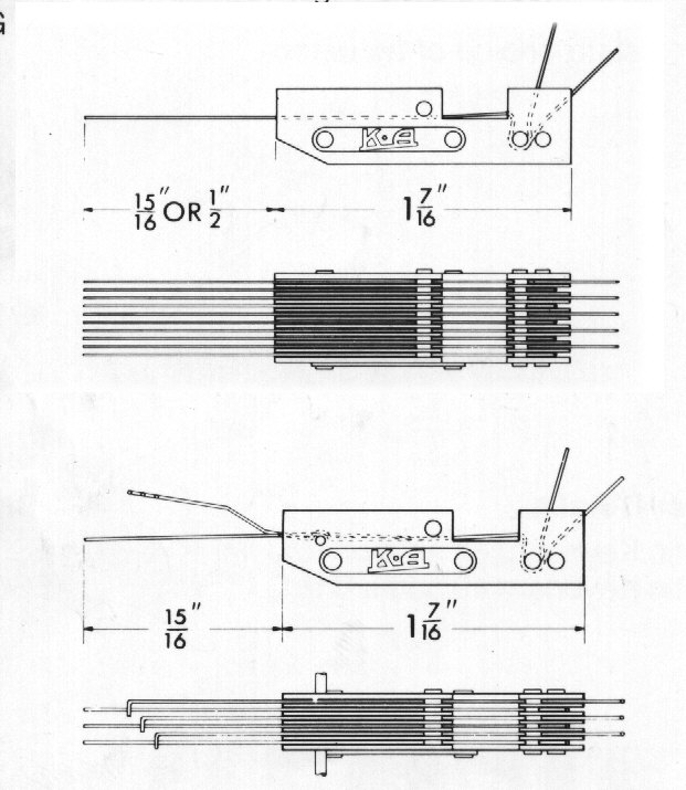

When I read your descrption correctly you have Kimber Allen key contacts or lookalikes, it's quite easy with those to set the moving wire contact on the wrong side of one of the fixed fires.

Sorry that they are a little dark, but you should get the idea. Each key has a 3x3 grid of holes in the plunger part that goes down. The two wires are inserted into opposite corners, so one is high and one is low. Both are normally not in contact with the keyboard, and I think they are supposed to both make contact with their respective bus bars at the same time. By "bus bars" I mean the thicker, stationary wires.
Any idea how this is actually working? I see the voltage divider network of resistors of equal value. They are all 1k (brown, black, orange). There are some SIP packages that I assume are capacitors for debouncing the switches. It looks like that's it. I don't understand how the keys could be making the same pitch tone if there would be a different voltage at each key's wires.
Do you know how these work?

I'm glad you found a cause. The keyboard is not quite what I had in mind, I thought you'd have switches like the ones pictured here Funny during the day I watched the pics on a CRT and couldn't make much from it, on this LCD it's much better.
Got the pic from http://www.kimberallen.8m.net/photo.html

This is the one, isn´t it?

That does look somewhat similar, though mine only has two wires per key. It certainly is an interesting mechanism.
The problem, though, at least on mine on mine, is that the wires bend a little over time. This puts them out of position, so some will only hit the trigger wire and not the CV wire, or some will just barely hit the CV wire, so the response is kind of wonky.
All I can really do to fix it is try bending the wires around until they happen to be *just right* to hit the keys the right way. Pretty frustrating to adjust, especially on a keyboard that is approaching 30 years old. Plus, they're close enough together that I sometimes hit other wires trying to get to one.
