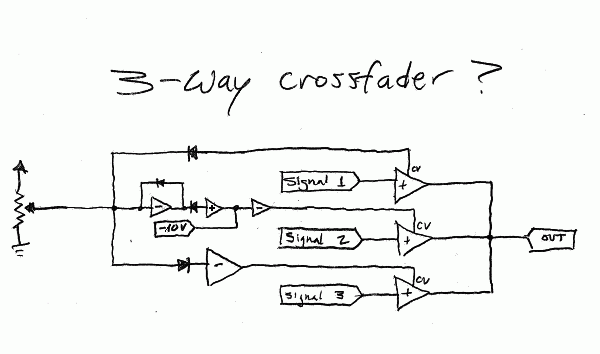

I've got a few different ideas that would work a lot better if I could figure out how to do this one thing: fade continuously between three sources using only one control. Take, for example, a VCA that can go from exponential to linear to logarithmic with the turn of a knob. That would be really cool! Or even just crossfading between three different audio sources, such as lowpass, bandpass, and highpass. All under voltage control. I'd quite like that.
I'm trying to figure out how I could set up a circuit so that a potentiometer (likely with a center detent, to make it more intuitive) could control such a circuit. 50% of it would crossfade between signals 1 and 2, and the other 50% would crossfade between signals 2 and 3.
I guess I could implement this by having a comparator switch between the two halves (1 to 2, 2 to 3) at the crossover point (probably 0 volts). I'd then need to have one pair of VCAs that responded to positive control voltages and another pair of VCAs that responded to negative control voltages. The only thing that worries me is having any type of glitch at the corssover point. If I were feeding a wave in to control it, and it had a little dropout or pop when signal 2 was at it's loudest, that wouldn't sound good at all.
I might be able to accomplish the same thing by using diodes to create two parallel half-wave rectifiers to send the positive CV to one half and the negative CV to the other half, but I'd definitely get a crossover glitch that way. Easier to implement, but worse result...
I've also thought about using a dual-gang potentiometer, but that probably wouldn't simplify it any.
Any ideas? Has this been done before? I did some searching, but I wasn't exactly sure what to search for. I think some Blacet modules might do something like this, but I won't know for at least a few weeks (when I'll have the money to make my big Blacet order!)

I just couldn't leave that one alone. I started sketching stuff out, and I think this just might do it.
This is a high level block diagram, and certainly not a complete schematic:
I need to work out a proper schematic, and then try it out!
bigtex
Joined: Mar 30, 2006
Posts: 323
PostPosted: Fri May 12, 2006 8:10 pm    Post subject: Reply with quote  Mark this post and the followings unread
Oh, a little explanation might be in order... first of all, the triangles with + and - in them are non-inverting and inverting amplifiers (or buffers) respectively.
So, starting at the left:
Potentiometer delivers a voltage that goes three ways (oh, I might need to put a buffer there to feed those three paths...)
The top one has a diode that will only pass the positive voltages (oh, did I reverse my diodes...??). Those positive voltages will be used to control the amplifier for Signal 1.
The bottom one has a diode that will only pass the negative voltages (yeah, I think I reversed my diodes...). Those negative voltages are then inverted by the inverting amplifier to deliver a positive control voltage to the amplifier for signal 3.
The middle path is kind of complicated. First, the voltage is full-wave rectified. This way, positive or negative, the magnitude of the voltage (regardless of the polarity) will ba passed along. Next, I sum the output of this with -10V. I do this to invert the magnitude of the voltage (different from inverting the polarity!). I invert the polarity of this as well, to make it positive again. So what was previously a voltage variable over a range of -10 to +10 I have turned into a 0 to +10V control voltage that goes high when the input is close to zero and goes low when the input is close to it's maximum.
Kind of a strange way to do it, but I think it just might do the trick. The only problem is that I'm still losing +/-0.7V around zero by full-wave rectifying this. The design for the odd way of full-wave rectifying was pulled from this page. I might change that method in the future as well.
So I think this is a good starting point. I might be able to use a capacitor to smooth out any glitches on the CV for Signal 2's amplifier. But, then, that would also slow down the response and make this less usefull for high-speed crossfading.
Can anybody improve on this or point out where I'm way wrong?

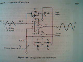

ive got this really awesome op-amp textbook witha great chapter entitled: op-amps with diodes. haha. it's super easy to follow. and cool- it describes the process of frequency shifting, and phasing and has some interesting oscillator circuits. here's a somewhat elaborate sine-shaper.

Oh, that's awesome. Not really even all that elaborate, either. I've been looking for a simple-ish circuit that does just that.
What detail does that book give on the "carrier adjust" knob. The word carrier makes me think of some kind of high frequency modulation, but I doubt that is what is going on in that circuit...

sorry kinda blurry huh. starting with the top, the trims are: peak adj., center slopes, and crossing slope.
yeah i guess not too elaborate. i guess what i meant was articulate, with three trimmers... fancy.

cool circuit! Some questions i have: Is it important which diodes and opamp i use? Are the trimmers r1,2 going to ground or -15v?

ground,Zipzap,if the illustrator uses a black arrow for the -15V,under the CA3140.

hey, yeah what robert said. nah, you could use others like tl08_ or whatever. diodes are 1n914.
in the illustration, it's shown that a 1.4v p-p tri input will result in a 2v p-p sine with the values shown.
