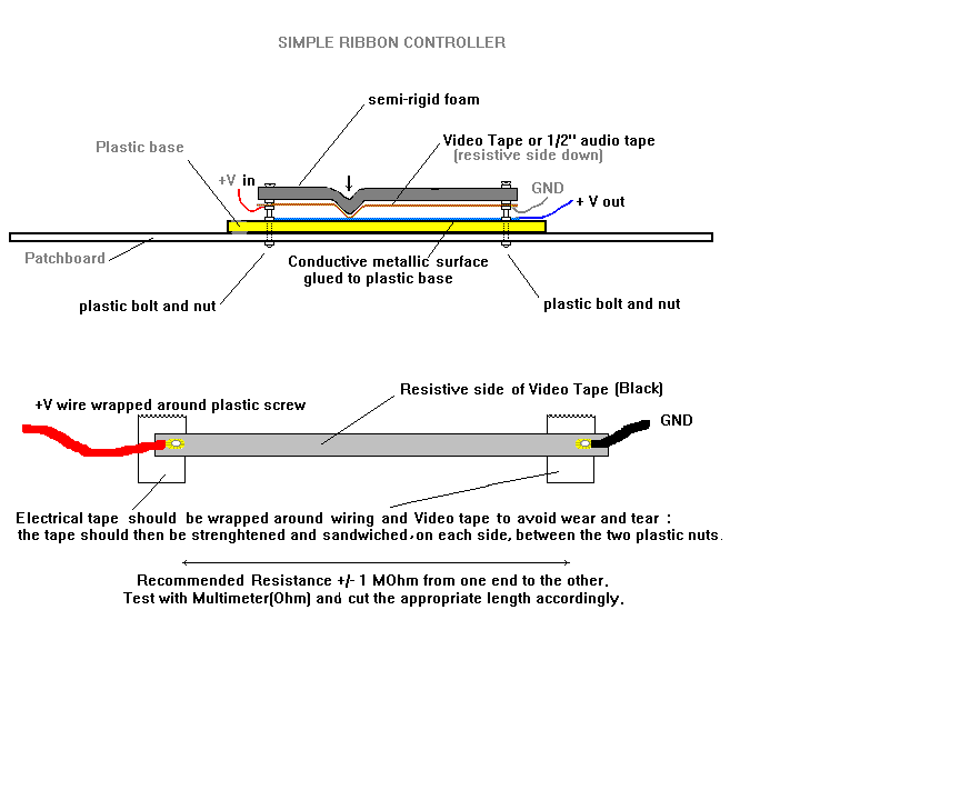

as saying in this thread repeate after me....r i b b o n c o n t r o l e r
i have some 4track and 8track tape that has nice resistance features
PEM 468 has 1M ohm /10cm (approx)
PEM 469 has 700K ohm /50cm (approx)
and you can hook up something like this:
just PM me your address and the tape will be on its way
daniel

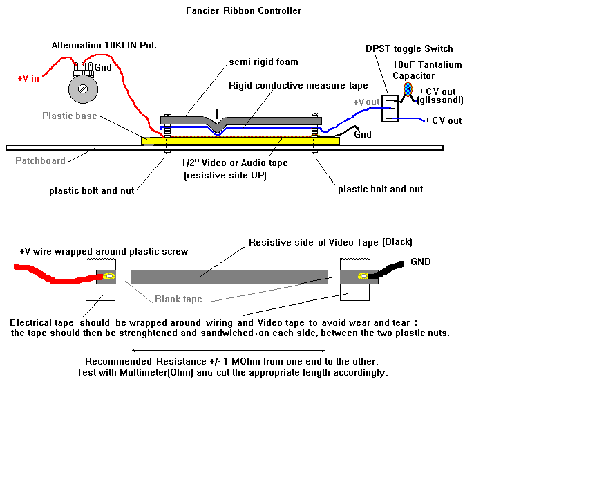

dnny
Joined: Mar 12, 2005
Posts: 519
Location: Helsinki, Finland
PostPosted: Wed Jun 21, 2006 1:03 am    Post subject: Reply with quote  Mark this post and the followings unread
here are some alternative and easy methods for ribbon controller construction.
The Synthstick
15 Minutes to a Ribbon Controller
www.koelse.org
