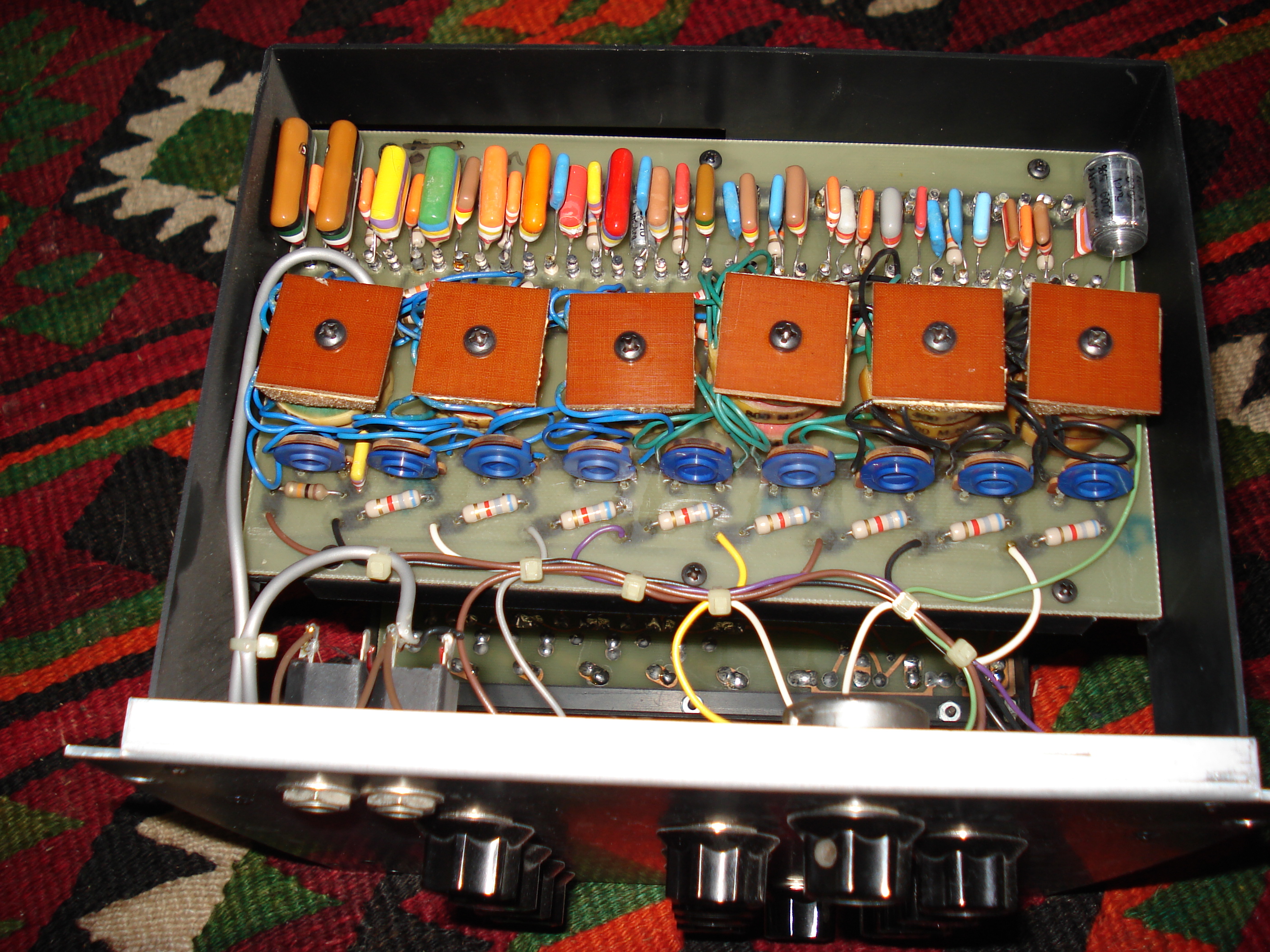

In another topic - http://electro-music.com/forum/topic-14632.html - we were discussing a bit about the Moog Fixed Filter Bank modules. I received this PM from 3PHase. I trust he won't mind me referencing it here.
Hi Howard,
thanks for the link to the Moog filter bank. i quickly found out why there are no remakes...
Moog didn't try to make the coils small... and therefore they are big part of the specific sound and not easy to build. The bass ones must be huge.
To rebuild a 907 module it would need to recreate the coils in a similar fashion as they done in the real thing...
Did you ever had a chance to look inside one of this modules?
How are the could done? around a ferrite shaft? or in a ferrite housing?
Or do they look like transformers with a metal block?
Ho w are they physical dimensions roughly? is the coil cable very thin or already in the 0,5 mm diameter region?
I don't know if you have answers for this questions ..but maybe?
Best regards,
Sven
Since it has been a long time since I looked at the innards of the modules in my Moog, I decided to open her up and take some pics of the 914 module. Maybe in this case the old cliché is true that "a picture is worth a thousand words".

PostPosted: Fri Dec 08, 2006 11:06 am    Post subject: Reply with quote  Mark this post and the followings unread
thanks..thats interesting...
the coils look like ferrit ring coils witch a lot of windings...
Nothing anybody like to do by hand...that and the perfect shape of them indicate an idustrial source... either specially winded for Moog or maybe some 'US standard product? Anybody came along such a produkt somewhere?
It actually looks like that Moog got the desired Values by combining multiple smaller coils. This also indicates an industrial produkt.

PostPosted: Fri Dec 08, 2006 11:22 am    Post subject: Reply with quote  Mark this post and the followings unread
3phase wrote:
Is it maybe possible to read one of this labels?
I guess one could tear into this and find some writing on the coils, but I started getting nervous just taking pictures of it so I have put it back in the case and secured the screws. I'm sure the sound is not dependent on the coils' manufacturer any more than that of the capacitors which are just as an important a part of the circuit.

PostPosted: Fri Dec 08, 2006 11:49 am    Post subject: Reply with quote  Mark this post and the followings unread
Dont want to force you to open it again...
The capaciators are an easy gool...just get good foil types and it should be wright in spec...
with the coil its probably different. The amount of windigs... core material..is it ferrit? probably..but dont have to be...
All this affects the sound very much as you can hear easiely when doing crossovers for speakers... it should be as drastical in a filter
Its defenetly interesting to see that a 5H coil is done out of 2x2H and one 1H...at least it looks like that...
I hope i find a non industrial source to experiment around a bit...

Mosc provided a link to the schematics in another thread...there its clearly stated that the lowcut is two 5 Henry coils...
That is easily backed up from the beautifull pictures in this thread...
Torodial inducters of that szise and with so many windings....
In relation to the power they have to handle, they are huge..
so no printing mistake in the schematics...
Ive never seen so beefy coils in a filter...even in the old Telefunken, Eckmiller stuff they managed it with 1,5H in the max...
And this units are known for good sound in mastering applikations because of theiere "huge" coils.

PostPosted: Thu Dec 14, 2006 11:20 pm    Post subject: 914 winder Reply with quote  Mark this post and the followings unread
Hi Everybody,
Noticed you are discussing the Moog fixed filter bank construction.
I have some info on these. The coils are toroidal and are wound on
three different type cores. There are ferrite, powderd iron, and molly
permalley cores. The winding amount is determined by the permeability
of the core and the value desired. These cores were manufactured by
the Allen Organ factory for Moog. All of the toroids came from there.
Funny thing is I have the actual machines and formulas used to
manufacture these cores. I am working on sources for the various
items needed to remanufacture these. At the moment I need a
permeability meter? And a few other things, (wax,cores)

SynthBaron wrote:
It may also be possible to scrap an old analog (before 1971) Allen Organs for inductors that are "close enough". I know mine had at least 122 of them in each generator section, and they had a minimum of two generators in an organ. They look exactly the same as the ones in the FFB. Sometimes 5 or 6 generator banks in a large one. You should be able to buy one for a couple of hundred bucks.
yes this had crossed my mind too. I had an old hammond or lowrey- can't remember now- but it had hundreds of coils inside Smile
ACHTUNG!
PostPosted: Sat Dec 16, 2006 3:46 am    Post subject: Reply with quote  Mark this post and the followings unread
How the hell do you wind a toroidal core coil anyway? Confused I'm assuming there is no gap in the core, but it seems getting hundreds of winds of enameled wire on there must be a bit of a magic trick. Shocked
