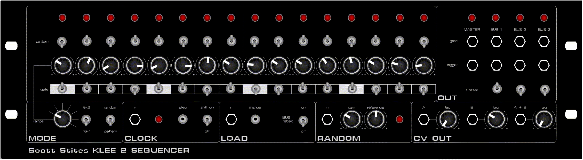

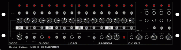

PostPosted: Wed Oct 04, 2006 5:44 am    Post subject: Reply with quote  Mark this post and the followings unread
i played a little with the front panel designer (schaeffer) during lunch brake and that's what i came up with, a 19''/3U frontplate:
- update 10 oct 06 -
"the gate grid" and the frames make this panel expensive, they can easily omitted. the holes are 7mm for alphapots and 8mm for cliff 3.5mm jack sockets...
it could look like this - update 10 oct 06 -

PostPosted: Wed Oct 04, 2006 7:49 am    Post subject: Reply with quote  Mark this post and the followings unread
That's a very nice looking front panel. Smile

PostPosted: Wed Oct 04, 2006 8:23 am    Post subject: Reply with quote  Mark this post and the followings unread
Of all the people out there doing this kind of stuff, I admire Ken Stone and Ray Wilson the most. They not only provide PC boards, but also make the schematics freely available. If one wants to build one of these designs, one doesn't necessarily have to purchase a PCB (though it quickly becomes apparent that using a PCB is often the most expedient method of building the design). In any event, one doesn't have to shell out $$ just to learn from their work, the volume and uniqueness of which is xtraordinary.
Fonik, that panel is just beautiful - far better organization than my mind has been able to conjure. Missing though is the rotary range switch I forgot to mention in my message to Coriolis. Actually, I've got some rotary switches from Allied that are really spiffy, no larger than a pot. Comes with a knob that's a bit smaller than I'd like to see, but still, it takes no more room than a pot will. I'm very thrilled to see you put in the "Shift On/Off" switch - that's a detail that should be put into the schematic. It is a very important control in the grand scheme of Klee programming.
The final schematic, CV mix, did add some additional controls and connectors. After seeing this panel, I'm thinking better of it.
These extra controls can be considered optional - they conform to how I've been using the Klee to make all of the samples.
The additional controls (3) and connectors (Cool are:

sneakthief
Joined: Jul 24, 2006
Posts: 569
Location: Berlin
PostPosted: Wed Oct 04, 2006 8:53 am    Post subject: Reply with quote  Mark this post and the followings unread
fonik - your panel looks great!
i have one comment though: the 16 knobs should really take up more width of the 19" rack.
last night i laid out 16 rean knobs (like blacet uses) on a 19" panel and it seemed to me that having around 35cm is a nice comfortable width.

PostPosted: Wed Oct 04, 2006 10:19 am    Post subject: Reply with quote  Mark this post and the followings unread
first i just want to say thanks for the positive feedback. i'll add the missing control tomorrow. it controls the range of the pots, am i right? so it should be placed in line with the programming pots (which seems not easy to do) or it can be placed in the cv out section (which is not that good but easier to do)...
sneakthief wrote:
i have one comment though: the 16 knobs should really take up more width of the 19" rack. last night i laid out 16 rean knobs (like blacet uses) on a 19" panel and it seemed to me that having around 35cm is a nice comfortable width.
yes, you're absolutely right! it should take more width. on the other hand i tried to use not more than 3U. i'll think about it, be sure.
i am used to have this 20mm spacing, i built my modular in eurorack standard and 20mm is enough for the 12mm alpha right angle PC mount pots i had in mind! but again, i'll think about it, it's just a first guess.
this project is seductive! i plan to build a 2nd cabinet with modules for my modular the next months, but this klee... overwhelming possibilities.
