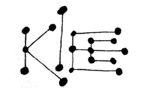

PostPosted: Tue Jun 26, 2007 5:28 am    Post subject: Reply with quote  Mark this post and the followings unread
After listening to what everyone said about my first one, and looking at what you all came up with, here's my latest one. Another chain in the chinese whisper. Hand drawn and then heavily filtered.
 Filesize:  22.63 KB

PostPosted: Tue Jun 26, 2007 2:08 pm    Post subject: Reply with quote  Mark this post and the followings unread
Uncle Krunkus,
Nice! I like this style, but prefer it with the layout of your first one.
(I think your original big K, crossing L and smaller e's was the best so far.)
IMO you got it right on the firdst try! This filtering and hand drawing just refines it...

PostPosted: Tue Jun 26, 2007 6:04 pm    Post subject: Reply with quote  Mark this post and the followings unread
I really like this one too. It seems to sum up a lot of the ideas which have been bouncing around, but draws them back towards a more recognisable font. Well done Photon!
