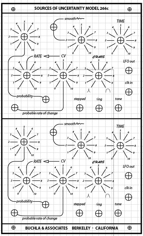

PostPosted: Tue Feb 24, 2009 7:49 am    Post subject: Reply with quote  Mark this post and the followings unread
FYI, Makenoise (who made some Woggles like the one below) has a new version in the works with some new features.
Makenoise Wogglebug
