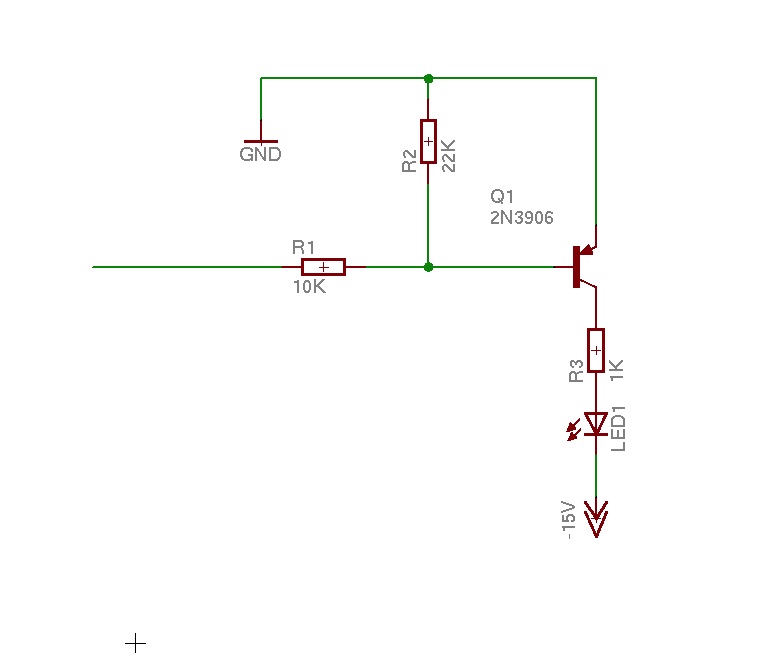

Sorry to resurrect this thread once again (actually I'm not really that sorry)!
I'm having the same problem xpmtl had. Did he ever get it sorted out? I just built 2 more bugs with the group buy pcb's, with the idea of having them behind a dual panel with all the extra features found in the wiard version. With both of the first 2 I built, I didn't wire up the lfo out jack, but I have with these new ones. However, the output seems pretty useless - stuck at 5v, with little dips to about 4v at the clocks (like the diagram xpmtl put up a page back) - seems inverted from what it should be.
And I'd also like to wire up an led from the lfo rate with the cgs pcb, but with that always-on voltage, the led doesn't really do much. I'm going to try some alternate places to connect the sensor wire for the led, but I'd still like to sort out the lfo out problem to make it usable.
Any ideas?

I tried running the lfo out through my cgs inverter and got the behavior I expected - short positive 5v pulses at the clock, 0v in between, and the led behaving correctly. So as the circuit is really simple, I'll just breadboard up 2 of those and hook them up behind the panel.

xpmtl wrote:
hi all,
I'm trying to add the cgs led driver to the clock out but i got into trouble as the pulse seems inverted.
The led is bright all the time and goes off for a micro-second. Anyone got the same results?
Do I have to use an inverter or is there a simplier way to solve that?
Pulse looks like the first one in the image attached, for correct operation it should be like the second i think.
thanks
A CMOS 555 can sink quite a bit of current, so it can drive the LED directly. Connect the anode to +15 volts, and the cathode through a 3K3 resistor to pin 3 of U4. It will turn on the LED only for those short pulses and behave exactly as you want.
Hi sduck,
i solved the problem experimenting on the breadboard. IIRC, I just used a pnp tranny instead of a npn.
If u need more info i'll gladly take the module off the cabinet and try to redraw something.
Edit : i've redrawn the circuit I think I used. If you gonna use it, please check it on breadboard before.. I'm not an expert at those things Wink

Thanks! But I went ahead and made a little inverter board and hard wired it back there, and it works great. I only discovered the problem after I had installed everything, and using the addon board made a little more sense than taking the whole thing apart. I knew the addon board was going to work, and I wasn't so sure about the other kind of fix, so the choice wasn't too hard. However, I'm sure your fix will help someone else down the road, so it's all good!

On this scheme posted by xpmtl is the 10k supposed to be linked to pin3 of U4?

tommi wrote:
I would like to have an lfo out jack on my panel to use as trigger out for ADSRs, drum modules or even to clock sequencers. Anybody can point me to a circuit i can use?
I inverted my LFO output so it would be a positive pulse instead of a negative pulse to use it as a trigger output. It is a fixed 7.4 mS pulse and there is a scope image on my site.
After doing this and playing with it a while, I later changed it to a 50% duty cycle square wave. I left the inversion since it was already done but this would be unnecessary with the 50% duty cycle mod. It did, however, make the green LED indicate the positive portion of the waveform (LED=on when the 555 timer output is low).
Details of my mods are on my site.
http://modularsynthesis.com/bridechamber/wb/wb.htm
For a fixed pulse-width trigger, modify U6A to the circuit modification #6.
For a 50% duty cycle, just do the circuitry in modification #10. You can connect the LED to the /Q output (LED=on when /Q low, which makes Q high, and with standard U6A circuit makes LFO out high).

tommi wrote:
Thanks davebr, i think i 'll do the inverter modification, it will do the job of triggering out short pulses for sequencers, etc.
The 555 will still be clocking U3(LF398) thru R27.
Correct
tommi wrote:
In place of R40 (49,9K) there will be a 300k resistor.
Correct
tommi wrote:
Another 300k resistor from +in to -V.
I just noticed that I got the + and - inputs backwards for the mod on my website. The 300K is to the - input and you should be able to use R8.
tommi wrote:
One 100k on the feedback path and the -in to ground. Is that right?
I swapped the + and - inputs so the + input is grounded. Take a look at the updated modification and I think it will be clear.
tommi wrote:
Is it tricky to do? How many traces to cut?
I'm afraid I didn't take very good notes. I made 3 cuts but in looking at it, I think you only need to make 2.
You have to cut the feedback loop from pin 1 to 2. That is on the top layer. R27 [error - should be R26] stays connected to pin 1.
You have to cut the input to pin 3. I did so under R8.
Then you have to connect the junction of R40/R8 to pin 2. You have to add a 100K feedback resistor (on the back) between pins 1 and 2. You have to ground pin 3.
That should do it. I think I used R8 as the feedback resistor so the third cut was the -15V . Using R8 as the other 300K resistor eliminates one cut. I didn't take a photo of the modification.

tommi wrote:
Dave,
Since the led it's directly linked to the out of U4 (pin3), i think that in case of external clocking it will still indicate the rate of the internal clock. This would be distracting...
I thought i could add an led circuit (cgs led driver?) to pin7 of U6B (the amp stage of clock in) to indicate the actual rate at wich the circuit is clocked.
Maybe i am wrong on the interpretation of how your led is ment to behave?
You have two choices - have the LED follow the internal clock or the wogglebug clock. I wanted to use the LFO for a clock generator for my CVS modules (that is why there are three LFO outputs) so I had the LED follow the internal generator. If I am driving the Wogglebug from an external clock source, that source will have an LED indicating the rate.
You can wire it up after U6B so it will follow the Wogglebug rate whether it is internally or externally generated. There are a couple of different ways to do that. One way would be to add a LED in series with D3 and change R20 to set the appropriate current (you could replace D3 with a LED if it had a 15 volt reverse voltage spec).
tommi
Joined: Dec 05, 2007
Posts: 247
Location: Italy
PostPosted: Fri May 07, 2010 8:53 am    Post subject: Reply with quote  Mark this post and the followings unread
One way would be to replace D3 with a LED and change R20 to set the appropriate current.
You ment that I could change R32(20K), maybe lowering it to make the led brighter? Are you sure that lowering the value of that resistor wouldn't affect some way the clocking of the S&H chip, i mean that it maybe could lower the level of the square wave?
