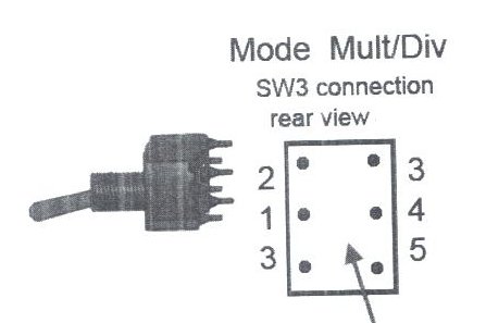

I'm trying to figure out the destination of the "connector pins"...that go to the "mode" switch, SW3....
(board pinouts 1,2,3,4,5)
...and to what kind of switch ?
The photo is not clear, but it looks like a 3PDT or....?
Anyone know this?

PostPosted: Mon Feb 26, 2007 8:07 pm    Post subject: Warp633...switch pinouts? Reply with quote  Mark this post and the followings unread
Hello - just joined this forum!
The switch in question is a DPDT. It is not obvious how to wire it up even if you bought PCBs from Marc, as I did. See my webpage for more info:
http://www.guitarfool.com/
http://www.guitarfool.com/modules/Warp633.html
This is one amazing modulator, BTW.
 Filesize:  36.56 KB
 Viewed:  249 Time(s)

@guitarfool:
Hi, is this top or rear view? The docs I got from Marc show the switch pins the other way around...
If I wire the switch both ways it just doesn't seem to modulate... Evil or Very Mad

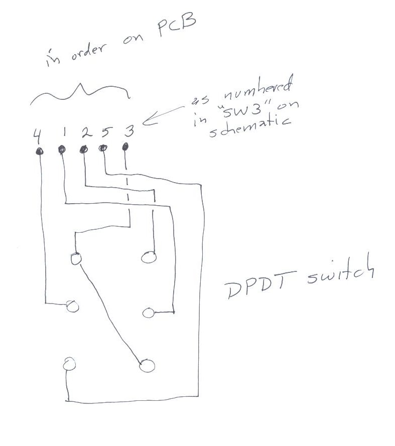

PostPosted: Sun Apr 20, 2008 6:11 am    Post subject:   Reply with quote  Mark this post and the followings unread
Hi all, I have been lurking for a wile and this is my first post here.
In the AD633 datasheet there is an example "divison" circuit and from that I can roughly determine how to wire the switch, but i can't figure out why the R17 / R18 divider is there or how that fits in the circuit.
Does somebody have an idea how to correctly wire this switch ?
welcome
I'm not real clear on this myself. I haven't looked at this in a long time. When the switch is in "divide" mode (4 connected to 5, 1 connected to 3), R18 and R17 attenuate the output of U2 which is fed to the "mix" pot.
I re-uploaded my drawing from before - it must have gotten lost in the big crash a while back. I've posted Marc's version below. The switch is a DPDT (on-on) switch, which is really 2 SPDT (on-on) swiches, so left-right (front-back) doesn't matter. That's why mine is a mirror image Very Happy
 Filesize:  16.15 KB
 Viewed:  4779 Time(s)

PostPosted: Mon Apr 21, 2008 4:28 pm    Post subject:   Reply with quote  Mark this post and the followings unread
Thanks guitarfool, that explains a few things
