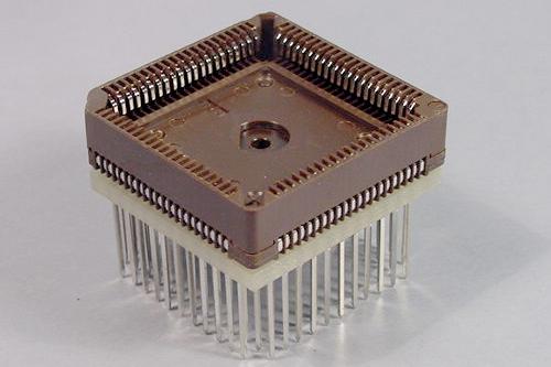

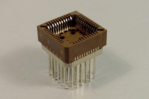

Guys,
Here is what looks to be a good website for prototyping adapters!
The prices are not that bad either.
The Keyboard circuit "integration" project is what the reason is for this post.
http://smt-adapter.com/Site/Wire-wrap-sockets,,PLCC.htm
Bill

Bill:
Thanks for all the technical support. If you are able to squeeze the circuit onto the 44 pin chip, you've have at least one thankful DIYer. Yeah, the midi option would be cool...down the road of course. I got to thinking about the fingered portamento. I think it might be easier to implement than I initially thought. The gate and trigger signals obviously already indicate legato vs staccato playing. A trigger could be derived from the gate signal and if both this trigger and the usual trigger is there, then no glide. If the normal trigger is there and the gate derived trigger is not there, then the glide is turned on. Glide is turned off by trailing edge of the usual gate signal. Glide turn on/off is a cmos switch in parallel with the glide pot. Well, that's just some initial thoughts and probably needs a lot of refining. I'm going to call that TH Kbd Rev 2 and the midi version Rev 3.
