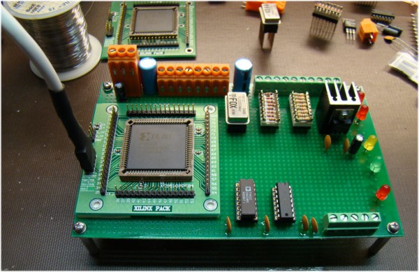

PostPosted: Fri May 25, 2007 6:12 pm    Post subject: Reply with quote  Mark this post and the followings unread
OK, I received the CPLD prototype adapter for the TH keyboard integration project. It also came with a XC95108-10 chip installed and the downloader cable. It is really very nice quality !!
This platform will be mounted to a larger prototype board with enough space for the other keyboard circuits (DAC , OP-AMPS, etc...) and "18F" controller IC for future MIDI expansion.
It will also have a 10 MHz oscillator and Terminal blocks.
Take a peek !!!
Bill

Posts: 2810
PostPosted: Tue Jul 10, 2007 7:27 pm    Post subject: Reply with quote  Mark this post and the followings unread
OK all, I have just completed version 1.0 of the integrated version of the "Thomas Henry" Keyboard. I call it the "Integrated Thomas Henry" Keyboard Very Happy Very Happy. Wow, original!
All of the present digital functions are all in the CPLD chip. Antman and myself will both have identical prototypes to do our further work in tandem.
I have also been thinking about adding the MIDI functionality right on the same chip and create a hardware USART for MIDI NOTE ON, NOTE OFF and VELOCITY messages. I know I had talked about using a separate MCU for MIDI but it would be a waste of logic real estate in the main CPLD. Right now, it functions as Toms does except that it scans 64 keys! The TRIGGER is now 3 milliseconds. It scans all 64 keys in 3.45 milliseconds.
I will share this design project as soon as we are done with it and add the features that we want.
Here is a picture of the prototype unit (minus the analog passives)... there will be two as I mentioned.
Bill
 Filesize:  132.36 KB
 Viewed:  276 Time(s)

State Machine and I agreed that this is a good time for an update on the project. The Rev 1.0 version design end is in sight, so if I were you, I'd start to keep an eye out for a cheap keyboard. I'd suggest not paying anymore than about US$10 (plus shipping) if you buy something off ebay/craigslist.
Bill sent me the prototype board per the last post and I've verified all functions operational per TH's original specs. All that's left is to wire up the analog portion and verify that. We finished the first draft of the schematic today. It's real darn simple: 5 IC's if you count the 7805 regulator and the 10MHz Xtal Oscillator, 3 if you don't! Bill's got all of Tom's original logic tied up into 1 chip (well, it is a big honking 84 pin one, though!)
Here's the best part: we've got a number of mods that can be used to customize it to your taste. I told State Machine that this keyboard is going to have the largest left hand panel of any keyboard I have (and I have 8!).
Bill and I have also found a fairly easy way to take the keyboard data and output midi. You'll have note-on's , note-off's corresponding to the keyboard with a few velocity options as well: you won't be stuck with just one velocity AND you can select the midi out channel. This is really exciting as there are no mono midi keyboards out in the market and as we all know, there are certain playing advantages not possible with a polyphonic kbd.

Dear electro-music Folks,
Here's the latest photo of the TH keyboard circuit prototype. All components are now placed on the board. I've drawn a square around the analog portion. Also, get a load of the documentation folder State Machine sent along with the proto-board! THAT'S a lot of work!!
Looks like great progress here !!! The logic integration seems to have gone well. Oh, sorry about the "Docu-tome". I have always been compulsive about documentation. Very Happy
