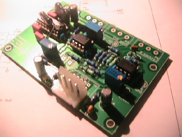

PostPosted: Sun Oct 21, 2007 12:51 pm    Post subject: Reply with quote  Mark this post and the followings unread
I'm in the final stage of building the fonik SSM from the first run.
for me it seems that the Motm Power connecter has to be tourned around for 180°.
Can somebody verify this please ?
Thats how i have the Power Connector now.
the Pin on the right side is V-.
Usually this is V+, isn't it ?
Thats how it looks now

PostPosted: Sun Oct 21, 2007 3:21 pm    Post subject: Reply with quote  Mark this post and the followings unread
Nice to see someone else's build, even when mine is working, just to make sure I am not an ass. I used ceramics up in the top left btw, and i didn't manage to find an 850pF capacitor so I just used a .1uF and it works too.
Anyway, yeah, the power point on the very right of your picture better be +V or you'll know about it fast.
Interesting point you make. I didn't use those connectors on my boards.

PostPosted: Sun Oct 21, 2007 4:09 pm    Post subject: Reply with quote  Mark this post and the followings unread
thanks for the answer,
so the print for the Motm connector is definitly wrong
( ----> that line that simbolises the back of the connecter )

PostPosted: Sun Oct 21, 2007 10:45 pm    Post subject: Reply with quote  Mark this post and the followings unread
you are right. the connector has to be rotated by 180°. it has been corrected on the 2nd run PCB.

PostPosted: Mon Oct 22, 2007 10:35 am    Post subject: Reply with quote  Mark this post and the followings unread
Up and running Very Happy Very Happy
ofcourse with multiple outputs Wink
And i changed the pots to the left, so i have some Space for the solderside of the Board( cos of shortenings when taking modules in and out)
BTW i eventually changed the wiring of the cutoff pot (as discussed before). i hooked it up between two 47k resistors connected to the power rails to have a wide control range...
