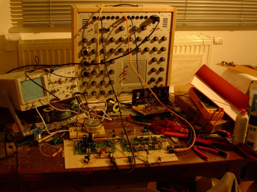

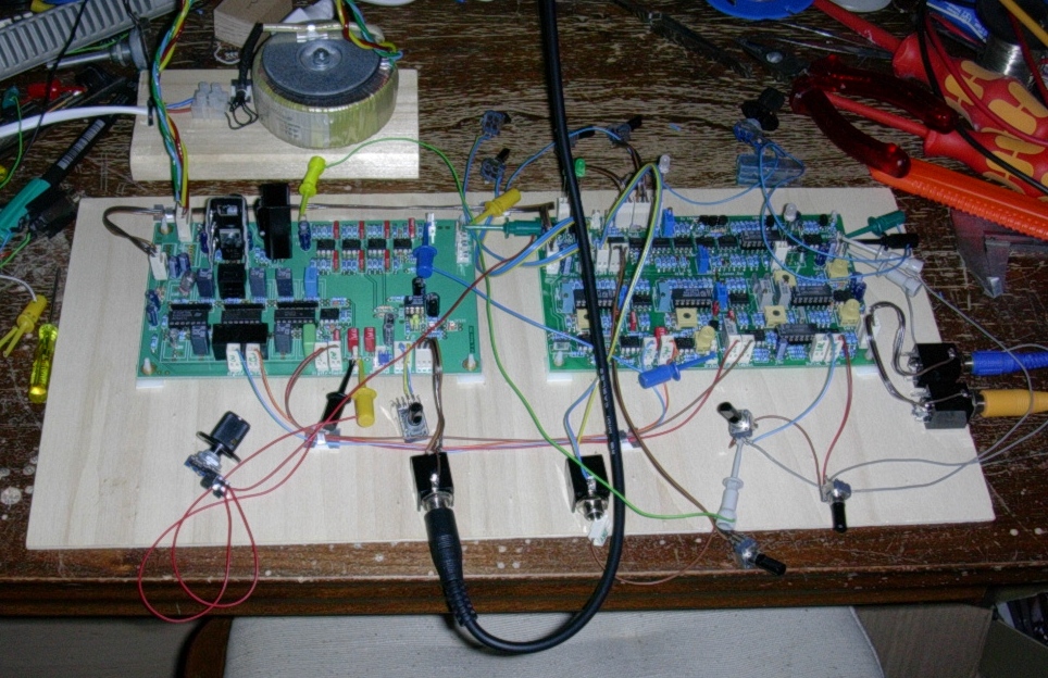

PostPosted: Mon Feb 18, 2008 1:14 am    Post subject: Reply with quote  Mark this post and the followings unread
Made some tests with the two boards fixed on a piece of plywood, and everything connected. Apparently everything works as intended!
I already have enough orders to let this project happen. I'm still accepting orders until the end of this month. If everything goes as intended, I'll have the boards by the end of next month!
JH.

PostPosted: Mon Feb 18, 2008 4:05 pm    Post subject: Reply with quote  Mark this post and the followings unread
FS-1a Testbench
JH.
