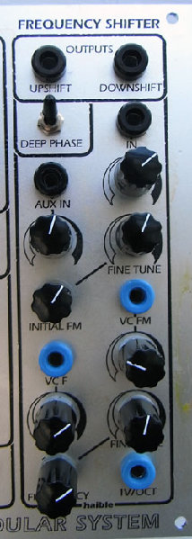

PostPosted: Sun May 31, 2009 6:40 pm    Post subject: Reply with quote  Mark this post and the followings unread
All done! Thanks JH for the design and trouble shooting help and thanks Tobias for the parts kit.
It's a FracRack format, Schaefer panel, 4U (6 inches) wide. I omitted the Mic input in favor of an additional audio level input so I could keep the feedback loop on the Aux. input.
The title is Bulgarian and translates to JH Frequency Shifter.
Now, maybe the phaser(s) or VCO's I've got waiting...
David

Ah, yes! Thanks.
I think I found the problem though - I have VCO that bleeds into the power lines. Causing my whole system to go banans. I'm gonna have to deal with that before anything else I guess..
Here's a picture of my, not yet functioning, frequency shifter.
 Filesize:  66.8 KB
 Viewed:  234 Time(s)
