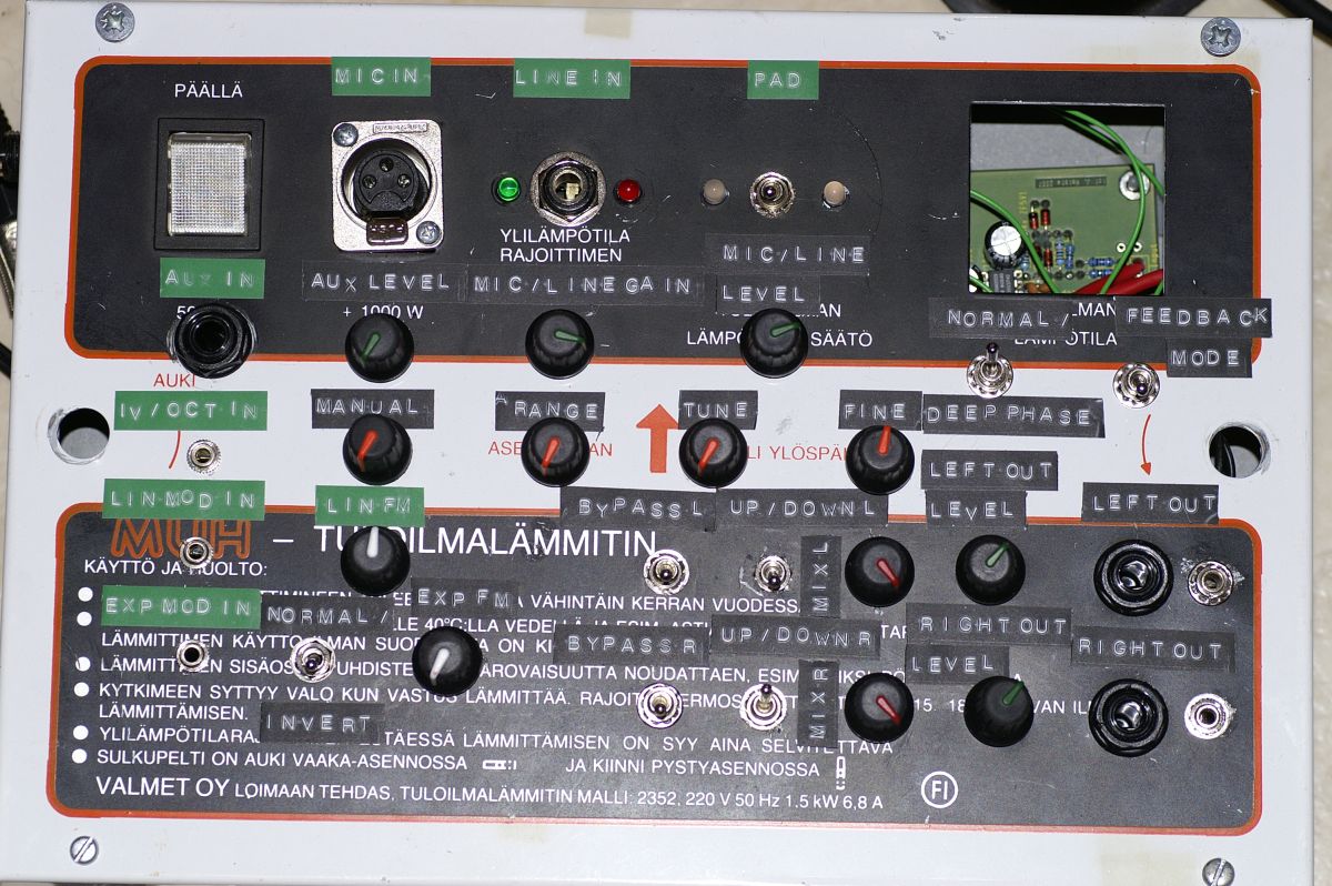

EDIT: Something messed up my post, so I'll have to rewrite it:
I incorporated basically all controls to my frequency shifter.
Being somewhat broke I used this box from an old air conditioner/control unit, which serves it purpose quite well. Perhaps it needs a new paint job, though. Laughing
Hope this photo helps a bit at least.

PostPosted: Wed Jul 29, 2009 1:08 pm    Post subject: Reply with quote  Mark this post and the followings unread
you messed here something up softfin Wink
thanks for posting the picture.
Hope to get some comments on the motm panels
