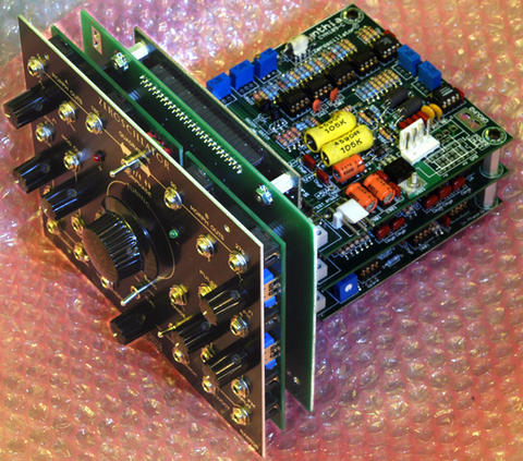

fluxmonkey
Joined: Jun 24, 2005
Posts: 708
Location: cleve
PostPosted: Thu Oct 04, 2007 6:42 pm    Post subject: Reply with quote  Mark this post and the followings unread
Peake wrote:
Whoa, these are 7 PCB kits? Perhaps I won't order six after all! Shocked
that's a pic of the guts of a cyndustries zero-oscillator, not the em kit being discussed...

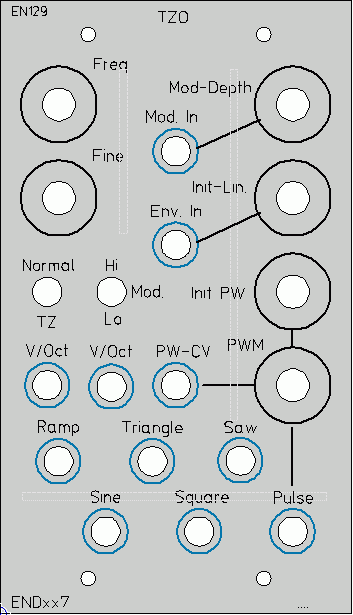

PostPosted: Fri Oct 05, 2007 3:30 pm    Post subject:
Subject description: EN129 TZO What to leave in? What to leave out?
Peake wrote:
"Your Majesty, what did you think of my Oscillator?"
(Salieri whispers into the King's ear)
"Too many parts."
Mozart, stricken: "But I assure you, there are exactly the right number of parts!"
Hi Peake,
Aye, that's the rub isn't it!
How many parts? What to leave in, what to leave out?
I am pretty certain the ZO core is indeed based on the EN129 circuit. As I work to solve the question posed; I find myself RE-"discovering" the path that I think "they" took. I can now see from the EN129 nearly all the way to the ZO. (If anyone has ideas about the tri to sine to square morph circuit; I'm all ears!)
But it's time to whittle the myriad possibilities into a module. And FWIW, it won't be a ZO at this point. I've tried to put pads into the PCB for the connections that will allow additional boards to interface and move that direction in the future. And I will pursue this over time.
But for now, I'd like to get the basic TZO PCB's into your hands.
I've taken to calling this one the TEEZ-io; because it teases towards the ZO. (FWIW, I'm working on three different TZ VCO designs. This is the first one I started, and will be the first released. As Andrew mentioned, these circuits do have their differences; so I believe each will be valuable in its own way.)
But I need your input on "what to leave in, what to leave out" of this TZO. So here's a prelim layout in Frac/Euro of one possible set of controls and IO. (The blue circles are jacks, the large black ones are pots. The small labeled holes are toggle switches.)
As presented, this is a fairly straight version of the EN129 circuit. It's pretty much as much as I can fit on this size panel without turning it into a jack minefield.
First question: How important is maintaining a small-ish panel/board size? It seems many have plans to use these in sets of 4 or more, so does size matter? Smile The cost of populating more extensive board sets also comes into play?
2nd question: Would you rather have more ZO type controls, instead of the varied waveforms? Perhaps you get basic TZ on one board for 18USD, and add the waveshaper features with a 2nd, and maybe even a 3rd board to get into ZO territory?
3rd question: How deep can this module be and still fit into your systems?
Because there are already 12 IC's on the board... (You can see that there are actually 3 boards shown; the main one with the 4 pots, a "jacks" and a "freq/fine" board. Right now these latter two are basically eliminating some flying wires, but they could become more populated with circuitry to take the "load" off the main board, and also reduce module depth at the same time.)
I do realise that not everyone is using Frac/Euro. But I hope to make this available as a completed module at some point, so the size and buildability does matter to me.
Because as crowded as this panel already is, there are things on the board which could come out to a panel. Like AC/DC FM inputs. Reversal CV input "switch". LFO/VCO range switch. LEDs.
A 4th question: Would you trade panel complexity/spacing to get more IO? IOW, the waveform jacks of this layout "could" be closer spaced, which would make room for more of them. (A triple VCO I'm working on takes this approach to stay in a double wide Frac/16hp Euro size.)
Perhaps more interesting is what could be done if the panel size were allowed to increase which then would remove restriction on IO, and then it would? make more sense to add the balmod (instead of the 2 quadrant VCA) and such which are in the ZO. Then perhaps it'd be worthwhile to have a Summed Linear node ouput, as on the ZO. Add Variable sync. Reversal input jack. The ZO bias switch. Attenuators/Inverters on inputs. Quadrature outs.
So please let me know what's important to you in this TZO module?
Kind regards,
Randal

PostPosted: Fri Oct 05, 2007 11:24 pm    Post subject: Reply with quote  Mark this post and the followings unread
I've no problem with modules the size of the Bode FS (and larger) if they give me what I want, and avoid being cramped.
I can't speak to analog TZ FM, but on the Yammies, you started with a sine wave, or close variations thereof, and used multiple oscillators to create new waveforms (two oscillators with feedback could create variable pulse waves with PWM via LFO, and sawtooth waves which could overfuzz with feedback, for example, making algo 42 especially useful for analog simulation).
But I'm not sure what TZ saw wave modulation would sound like. (Saw to saw, not the creation of a saw via two sine waves.) Might be interesting, where in Yamaha land, it would just be uncontrollable noise.
Would you use Molex or socketry for board-to-board connections, if there are multiples and especially later releases adding features, to ease installation (avoid the CS-80 effect)?
Thanks for taking this on. (Oh, and yes, AC/DC FM switching please.) Soft and hard synch?

PostPosted: Sat Oct 06, 2007 9:09 am    Post subject: Reply with quote  Mark this post and the followings unread
@Randal
I'm a little bit confused about your post ( also doe to my not so good english )
Is this now a Thru Zero VCO or not ?
about space:
while tourning one knob, one can alter another when they are to close.
Thats not what i would like to have on a ZO. ( or any other VCO )
My Opinion: give them some space !
Sockets can be close.
a modular modul: (?)
The Zero, i'd like to have NOt in a cutted-down version.
but to have the electronics in several function blocks which are added to a base Modul might be useful,
if one has to debugg the Modul.
so you can start with the minimal configuration and working functionblock per functionblock upwards.
But i really like to get those Boards at the same time, and as ONE Modul !

PostPosted: Sat Oct 06, 2007 12:42 pm    Post subject: Reply with quote  Mark this post and the followings unread
Hi Peake,
Thank you for taking the time to reply!
Makes sense. I think the "if they give me what I want" part factors in pretty heavily? To wit, the EN129 is a full-featured VCO which happens to allow TZ operation. Compare this to a "Yammie osc" in analog that might only have a sine output and means for hooking up in the various algo's arrangements. Pretty different goals between the two, I think. Really big difference in panels and circuit too.
My post is an attempt to see where the users of this module stand along the "line" of features described, from austere (Yammie like) to complete (ZO?).
But I'm not sure what TZ saw wave modulation would sound like. Might be interesting, where in Yamaha land, it would just be uncontrollable noise.
True. Again, with such a wide ranging topic as electronic music, sounds, noize; it's hard to say what one person might find compelling. (Which is why the first pass layout presented is tilted towards the complete vco with TZ end of the spectrum.) Looking to open up a feedback channel! Very Happy
LOL! That thing is a BEAST! A beast I wouldn't mind having, BTW. Smile
Yes, I provide MTA (.100) connections for all panel mounted items, and will use headers to go between boards. Pots can be board mounted or not, simply use the provided holes to put in an MTA header instead.
Thank you for your replies. It's much harder to make a PCB for general use than to simply fulfill MY desires only. So I appreciate the feedback!
Hoping to hear from Frac users as that format panel increases in 1.5" increments; where Euro can simply add .2" as necessary. Makes Frac (for me at least) the hardest format to design for.
Got it on the AC/DC. Sync could be variable from hard to soft as in the ZO?
Kind regards,
Randal

PostPosted: Sat Oct 06, 2007 4:02 pm    Post subject: Reply with quote  Mark this post and the followings unread
Funky40 wrote:
Im a little bit confused about your post ( also doe to my not so good english )
Hi Funky40! I'm quite sure your English is MUCH better than any attempt of mine in your language!
Yes, it is a TZ VCO.
about space:while tourning one knob, one can alter another when they are to close. Thats not what i would like to have on a ZO. ( or any other VCO ) My Opinion: give them some space ! Sockets can be close.
Do you mean more space between pots than shown here? This is typical Euro/ Doepfer /Blacet type spacing.
a modular modul:(?)
Well, I suppose it could end up a bit like that. But not too much.
The Zero, i'd like to have NOt in a cutted-down version. but to have the electronics in several function blocks which are added to a base Modul might be useful, if one has to debugg the Modul. so you can start with the minimal configuration and working functionblock per functionblock upwards. But i really like to get those Boards at the same time, and as ONE Modul ! ( not only doe of shipping costs )
Thank you for the comments. Every reply helps.
Randal
Yes, in your example the Pots are extremly close.
I know, this situation is difficult.
Many People seems to give to much for the optics and forget the functionality about,
or cannot imagine the influence to the functionality.
Ask yourself:
what counts more on a TZO VCO,
the matching optics or the function ?
and as i sayed:
when tourning one knob, one can alter another .
I really recommend to give the Knobs some space .
And i would give it also a multiturn with big knob ( i do this for all my VCOs, but the multiturn is on the finetune pot )
but as this module is anyway for DIYers, that Frontpanel thing seems not really the main Problem.
Maybe just wait with the Panel and look what modules first builders are doin.
btw.: i thought about.
That "Yammi Osc" Idea is good.
I'm one of those who like to have that 6 operator FM in analog.
But the Answer is open if it will work satisfaying
