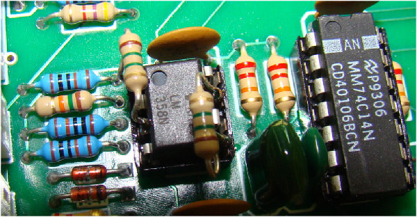

Photon wrote:
wasn't there a version of this with two shades of green for the keys? I seem to remember seeing photos of that somewhere.
looks like a different model. file description says 1969. the year this little photon flickered into existence Wink

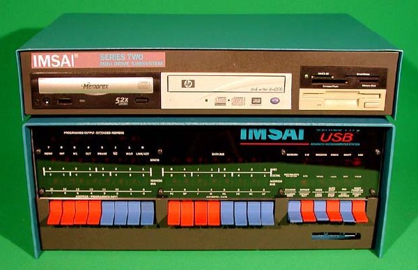

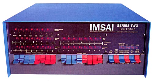

Agree about the toggles. When everything was entered in by switches; they were pretty nice to use. As Edison sez; there's no way we could've flipped the hex on bats as fast as we could with these, hex.load.hex.load.
Here's a couple pics of a new clone of the one I used to toggle a bit back in high school.<G> Then we got a '33 teletype and life was much improved!
The IMSAI Has the right number of toggles too...
It appears they're making some different updated clones (note the second pic), so this may be a good resource for finding the switches, etc.
These pics came from: http://www.imsai.net/
Fond memories.

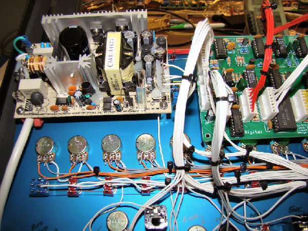

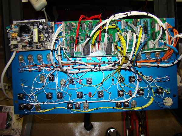

Well, here is the entire finished Klee with the power supply mounted. Another view of just the power supply and another of an example of some of the modification we were doing during the testing. Keep in mind that the finished circuit boards will have no such components hanging onto the IC's like this. All the changes are fully incorporated into the PCB design. These two resistors are "lap" soldered right onto the pins of the operational amplifier legs. This particular modification added 140 millivolts hysteresis to the clock and load input comparator amplifiers.
Bill

state machine,
that looks a lot like a pc power supply - is it one?
i thought the consensus was that pc power supplies are bad for synth use,
OTOH, the klee is not a synth...
please enlighten me.
Posts: 2810
PostPosted: Tue Sep 25, 2007 5:48 pm    Post subject: Reply with quote  Mark this post and the followings unread
No, actually, it's not a PC power supply. But a good guess as all PC power supplies are of similar topology. It is a switching power supply in what they call an open frame. This one is a +/-15VDC & 5VDC supply. I am not using the 5V output. Astrodyne makes this one. I have attached the data sheet for the series. This one is in the PT-65 series and is the PT-65C.
Generally the frequencies used by the pulse width modulators inside the switching power supplies will not be a problem when using them in audio applications when properly utilized. Lots of audio gear now has switchers powering their circuits. The debate of using switchers over linear supplies reach religious proportions. I say, if you can't hear any difference, then use it.
