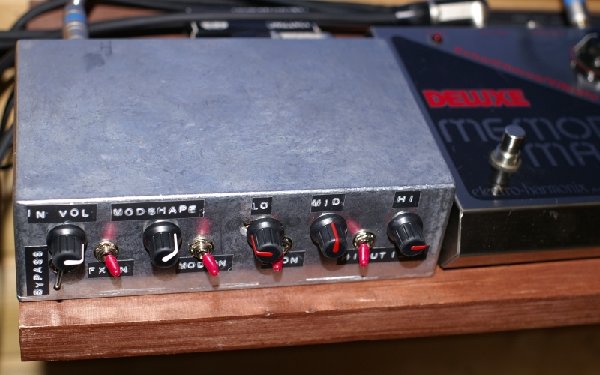

PostPosted: Sun Feb 17, 2008 2:34 pm    Post subject: Reply with quote  Mark this post and the followings unread
Here are some photos of my finished Solina Smile
I didn't have standoffs so I used this improvised method to mount the PCB inside the box.
It is adhered to the bottom plate of the box by means of screws, nuts and some glue.
 Filesize:  289.82 KB
 Viewed:  389 Time(s)
The board is mounted :) It fit just perfectly inside a 188x120x53mm Eddystone aluminum box.
 Filesize:  422.01 KB
 Viewed:  446 Time(s)
In the studio and sounding great!
 Filesize:  277.33 KB
 Viewed:  448 Time(s)

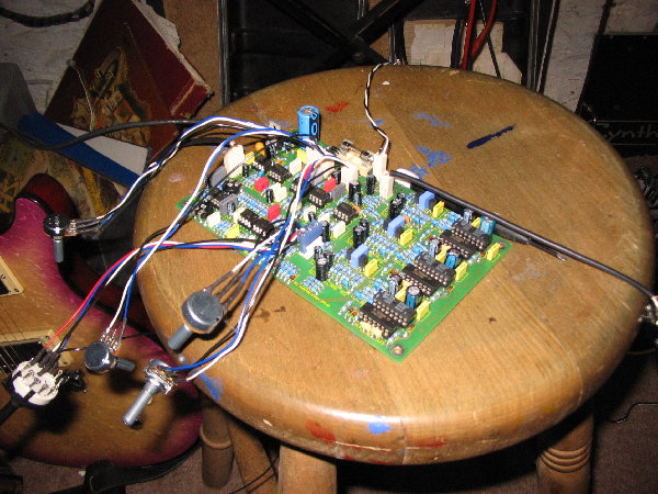

PostPosted: Wed Mar 05, 2008 10:18 pm    Post subject: Debugging the board Reply with quote  Mark this post and the followings unread
Sad
I just finished building the board and no sound is getting out.
What could be standard testing methods to make sure everything is in order, like verifying voltage on IC pins, etc...
Whomper
jhaible
Joined: May 25, 2007
Posts: 2014
PostPosted: Thu Mar 06, 2008 12:32 am    Post subject: Re: Debugging the board Reply with quote  Mark this post and the followings unread
whomper wrote:
Sad
Whomper
Have you connected the switches?
JH.

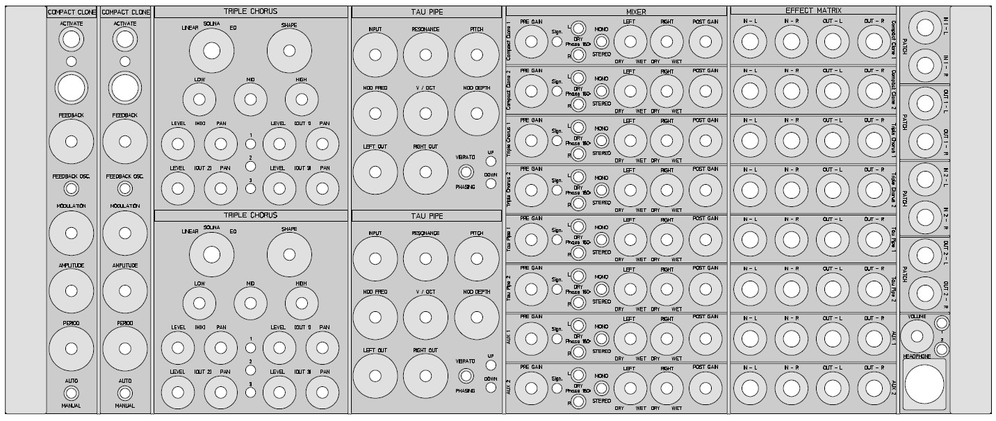

The 4011 worked fine, including the LFOs. The problem were only some of the 1022s, apparently randomly not starting to work. Anyway I tested the board again yesterday and all stages worked ok. Who knows what happened..
I've also designed (still not builded) a panel for a JH multi-effect box Wink Here is a preview:
 Filesize:  253.83 KB
 Viewed:  335 Time(s)
jhaible
Posts: 2014
PostPosted: Thu Apr 03, 2008 5:07 pm    Post subject: Reply with quote  Mark this post and the followings unread
Wow - that looks impressive!
Leave room for more projects to come. Smile
JH.

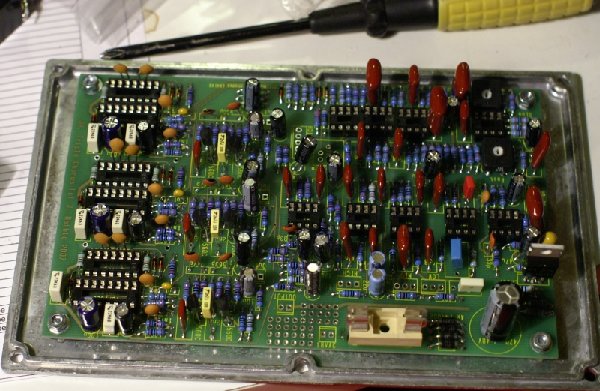

Victory! Just tested it, played the lambda thru it, it works!
 Filesize:  1.17 MB
 Viewed:  271 Time(s)
norman phay
Joined: Jun 29, 2007
Posts: 176
Location: North-East England
PostPosted: Fri Apr 11, 2008 5:26 pm    Post subject: Reply with quote  Mark this post and the followings unread
+ man, switching in the Lambda's built-in ensemble effect, then running it through this makes for plenty of sonic motion! Will get some mp3s made over the next couple of days (too tired now, it's 1.25 am here.)
Thanks Jurgen.
