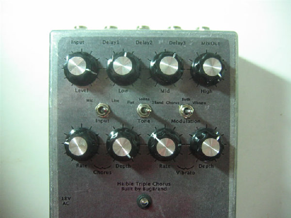

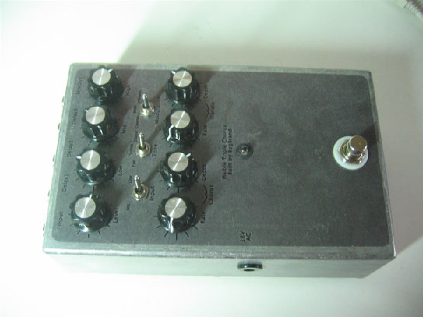

PostPosted: Mon Jan 28, 2008 3:02 am    Post subject: Reply with quote  Mark this post and the followings unread
Hey,
Just to report that I delivered the first pedal last night ---- there was a very very big smile from the receiver!
We tried the chorus with a proper Solina and very much liked sound - absolutely the same! But, of course, there's loads of other possibilities too!
The 3band EQ setting is very powerful - the Mid band, when cranked, seemed to really emphasise lovely harmonic content. Though, even with the treble cranked there seemed to be less of the very high end present. Am I right in thinking the EQ section was inspired by a particular keyboard type?
I added Depth dials to each modulator section as detailed on Jurgen's page, plus a 3 way switch (one of those C&K type On.On.On switches) to allow just Chorus, just Vibrato or both (again, using details off Jurgen's page -- 100u caps to ground). These extras allow so many extra and more subtle settings to be dialed in.
The only bad-ish was when we tried guitar into it and found the noise floor to be quite bad -- I'd added a little hi impendence buffer circuit, switchable on the input, but it turned out that the input level really needs to be high (ie line, not guitar) - when we added a boost pedal in front, keeping the levels higher, the resulting sounds were super lovely -- in fact, I had to excuse myself after a while 'cos my mate would have quite happily played for hours!
Overall results = freaking awesome!
 Filesize:  44.44 KB
 Viewed:  241 Time(s)
 Filesize:  54.39 KB
 Viewed:  248 Time(s)
http://www.bugbrand.co.uk
