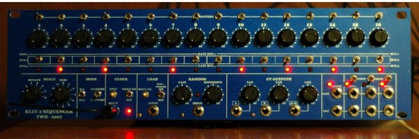

OK, now we're talking! CV outputs and scaling now working. Manual step switch bounce resolved. Scott, the step switch bounce turned out ot be a funky 4093 CMOS chip. I replaced it and now it is fine. The load switch still has a mind of it's own. It seems to load the pattern every time but it will cause the shifting to freeze sometimes and sometimes not. Since the load actually works I don't think it is a bounce problem. I suspect something strange related to 4013 flipflop. I'm still looking into that. The scaling accuracy is really good. I will post some performance numbers later on. If this helps the supply current drain (+/- 15V) is about 30mA on the negative supply and about 90mA on the positive supply in a shifting condition.
Tim

I reiterate: Holy Cow!! This is great news! What really amazes me is how you fit that all onto one board. Your perfboarding skills are amazing.
Thanks for the current draw number - that's right in line with what I recorded, forgot, and Fonik reminded me of.
The load thing might indeed be the CD4013. IIRC, the debouncing on that is a bit different, and the debounce cap serves also to provide a narrow pulse. Now, one thing that might isolate it is if the load reacts to an external load pulse the same way or not. The external load pulse and the manual load pulse are ORed together (IIRC, the schematic isn't in front of me), so if a wide load pulse does the same thing, I'd look at either the CD4013 or the CD40106 that provides the reset one-shot.
I'm eager to hear what you think of the thing (if it was worth the task of wiring that thing up).

Hi Scott, I got the Klee hooked up to synth an played for a little while...WOW very cool! It makes a normal sequencer seem rather boring.
It's going to take me a while to get out of the normal sequencer mode, and get my brain wrapped around everything that is going on in the Klee. With just a few minutes of playing I have gotten some pretty cool sounds already. I need to go back through the Klee threads and pay closer attention to some of your patches in order to get a better feel of it's capabilities.
Here's are some early observations:
1.) The load switch works pretty much every other time(not always), and with an external load pulse it works every other time consistently. I'm wondering if I mis-wired the load section. I really haven't analyzed what you are doing there completely , so I need to think about that section.
2.) As bits are added to pattern the pitch can quickly go out of hearing range, so much so that you have to tune down the VCO. I was wondering what you thought of fixing the Max Voltage to the CD4066 switches to say 5 volts and then doing the scaling in the output circuit instead.
This would do two things: 1st) Allow positive and negative with the octave scale. 2nd) I noticed with the Octave and Semi scale switches both set to minimum there is no CV at all, which makes sense because this is the only supply to the CD4066 bus. Scaling on the output with a fixed MaxV would guarantee that you would always have some CV going into the CD4066 switches. I'm not sure if I am thinking clearly here but it seems like since the shift register bits are all summed together your are going to get multiplication of of the scale voltage, not just the individual pot voltage settings. With this in mind, I think that you would only get true octave scaling when there was only one bit set. By Scaling in the output amp section, the multiplication of the scale voltage would not occur. Am I making any sense here? Another thought occurred that by scaling in the output you could do the A, B, and A+B channels independently. Maybe all three channels could be driven by the existing Octave and Semi rotary switches and you could add a center off toggle switch to each channel that would allow you to go +/- an octave separately.
Overall I am extremely pleased and after I have gotten some sleep and my eyes have cleared up from the solder smoke I want to really dive into some serious Klee patching and sound generation. Thanks again for your design, help, compliments, and encouragement!
Tim

PostPosted: Wed Aug 22, 2007 7:19 am    Post subject: Reply with quote  Mark this post and the followings unread
That idea was actually approached, but if you think about it, it would still hit the rails pretty easily before attenuating the output. If you set it to some value that would prevent it from hitting the rails before attenuation, then you're limiting the max voltage swing you can get with low bit density patterns.
The original Klee had around 14 or so volts on the pots, and, though there were only four of them, it was very easy to make the thing swing ultras-sonic and infra-sonic as well. So each pot had to be tuned carefully, and one had to pay attention to bit density, which wasn't so easy, because the only way to program it was through the random input (one couldn't load patterns), and there were only four LEDs - one for each tap of the CD4006 shift register. That fact and the pots being interactive led me to describe it as akin to molding loose clay. That's the reference Romeo Fahl used to coin the term "Klee", because of the clay reference combined with the abstract style of Paul Klee's art.
When I started messing around with the Model 2, which has sixteen pots, I started thinking about how to limit the voltage on each pot so that things would be easier to program. The thought struck me to use tuned intervals as the max voltage, and these intervals would have to be fairly small, with sixteen pots. I also still wanted to preserve the essence of the original Klee - though it was a bitch to program, it still produced some very interesting patterns by the mere fact it was so volatile. That's why I prefer to leave at least one larger range there (I think 4 or 5 volts is good).
Anyway, I could either limit that voltage before or after the mix. Before the mix would eliminate the need for multiple attenuators. After the mix, one would either need three stepped attenuators to easily reproduce a pattern, or potentiometers, which would make tuning a bit more fiddly.
The solution was to go for a mix of small intervals, and a large one or two (and a variable one, if one goes for that option, which I recommend). The large range preserves the original Klee functionality, and also allows one to use the Klee as a normal one step sequencer with a decent range as well. In your case, you went for the semitone and octave switch option of the model 2, right?
Anyhoo, the small intervals make the thing much easier to get interesting and repeatable voltage patterns out of it. One method is to program a pattern in the 1 volt range, and then try the lower intervals - often the voltage pattern is transformed in some very cool ways.
No, you should only get the pot voltages. If a pot is set to produce zero volts, it will contribute 0V to the pattern. The bit selects a CD4066 to pass the selected max voltage. This max voltage from the CD4066 goes to the top of the pot, the center tap of the pot contributes the voltage to the voltage mix. If the pot is turned all the way down, nothing is contributed, and if it is turned all the way up, it contributes the max voltage. Any setting in between full CW and full CCW of the pot will contribute that voltage (between the ranges of 0V and the max voltage)
So, if you have a bit pattern containing 7 bits, but only one pot set to contribute, say 1 volt, throughout the pattern a V/Oct VCO will jump up an octave seven times. If you have two pots set for 1V, when the bits select both pots, you will get two octaves, when the bits select only one pot, you will get one octave, and when they are not selecting either of the pots, you will be at the base frequency of the oscillator. So, with two pots set in this instance, you should get a pattern containing a combination of three octave notes.
If the second pot is set halfway, it will contribute only a half an octave, so now the voltage pattern should be a sequence that spans four notes - the base note, half an octave up, an octave up, and an octave and a half up.
Well, the scale voltages shouldn't be multiplying - only the voltages tuned by the pots should be contributed to the mix. Is this the case, or am I misunderstanding your question? In other words, I rarely have anything go ultrasonic unless I have something greater than 1V range, and a high number of bits and a fairly large number of pots cranked up.

Okee-dokee, Tim. Here are the pot settings I have on the breadboard. The last several samples I've posted used them.
1 = full on, 0.5 means set halfway, 0 is all the way off.
Range: 1V (1 Octave).
Pots:
1. 0
2. 0
3. 0
4. .5
5. 0
6. 1
7. 0
8. 0
9. 0
10. 0
11. 1
12. 0
13. 1
14. 1
15. .5
16. .5
With this setup, I like to run one voice with output A and the other voice with output B. I generally use A+B to control the cutoff of one of the filters with these settings, and one of the other outputs to control the cutoff of the other filter.
Start off with a pattern that has between 5 to 7 bits. Every so often, flip between 8X2 and 16X1 (or vice versa) just to randomly juggle the bits.
For the Gate Bus, I'll experiment - generally I will have no more than 1 or 2 switches set for Bus 1 and one or two set for Bus 3 - the rest are in the center Bus 2 position.
I like to patch triggers and gates from separate bus outputs for a single EG (and do it for both voices). Like, for instance, the gate from bus 3 and the trigger from Bus 1 will control one EG, and the other EG will be set up with some other combination. Lately I've been patching the Voice A VCO's sine straight into the mix, or I will run the sawtooth through another filter and control that with a third EG. I then mix it in and out (as I do with all the voices at different times). Play with the EG settings extensively, too. Do the merge switch thing - trigger an EG only with triggers from a merged/unmerged bus.
I'll tune the oscillators up and down, usually with short, stabby EG settings til a relationship catches my attention. Generally I'll tune the A voice higher and the B voice lower, but not all the time.
Main thing is, just experiment to your heart's content. Don't be afraid the twist a pot here and there while you have a pattern going. Or shuffle bits around with the load function, too. When you have a good groove going, start playing with the range switches without touching anything else. Crank a filter's cutoff intermittently. Modulate the filters with LFO's - nice interactions with the pattern often occur.
Especially if you run the voices out to a delay, man, you'll find yourself hearing the birds chirp at dawn before you know it. Your significant other will eventually become confused with your unexplained absences in the la-bohr-atory.... Very Happy

Wow, thanks Scott for the details in your last post.
My mistake on the first test run last night was to approach it like a normal seq. I set all of the pots so that it walked up the scale which sounded normal with one bit set. Then I started adding bits and it got out control fast as you can imagine. I also was gating only on the main so it got to be pretty brutal for me and even more so for the cat!
Anyway, tonight was a totally different story. I started out following your Ops Tips (few switches, few pots with low pot settings) and setup two voices with different gates and CV buses. Amazing, it's now starting to remind me of a Scott Klee sample. I think the cat even liked it this time!
I'm not ready for prime time posting of MP3 samples yet, but soon. I think if I had built the Klee 1 first and gotten the feel on that, then the migration to Klee 2 would have been more natural. Man, there are a lot of switch and knob combinations on the Klee 2! As you said, one small tweak of a knob or switch can really change the whole character of a sequence.
I am certainly going to play with the values in your last post and put it through it's paces. I quickly found out tonight that I need more patch cords now.
