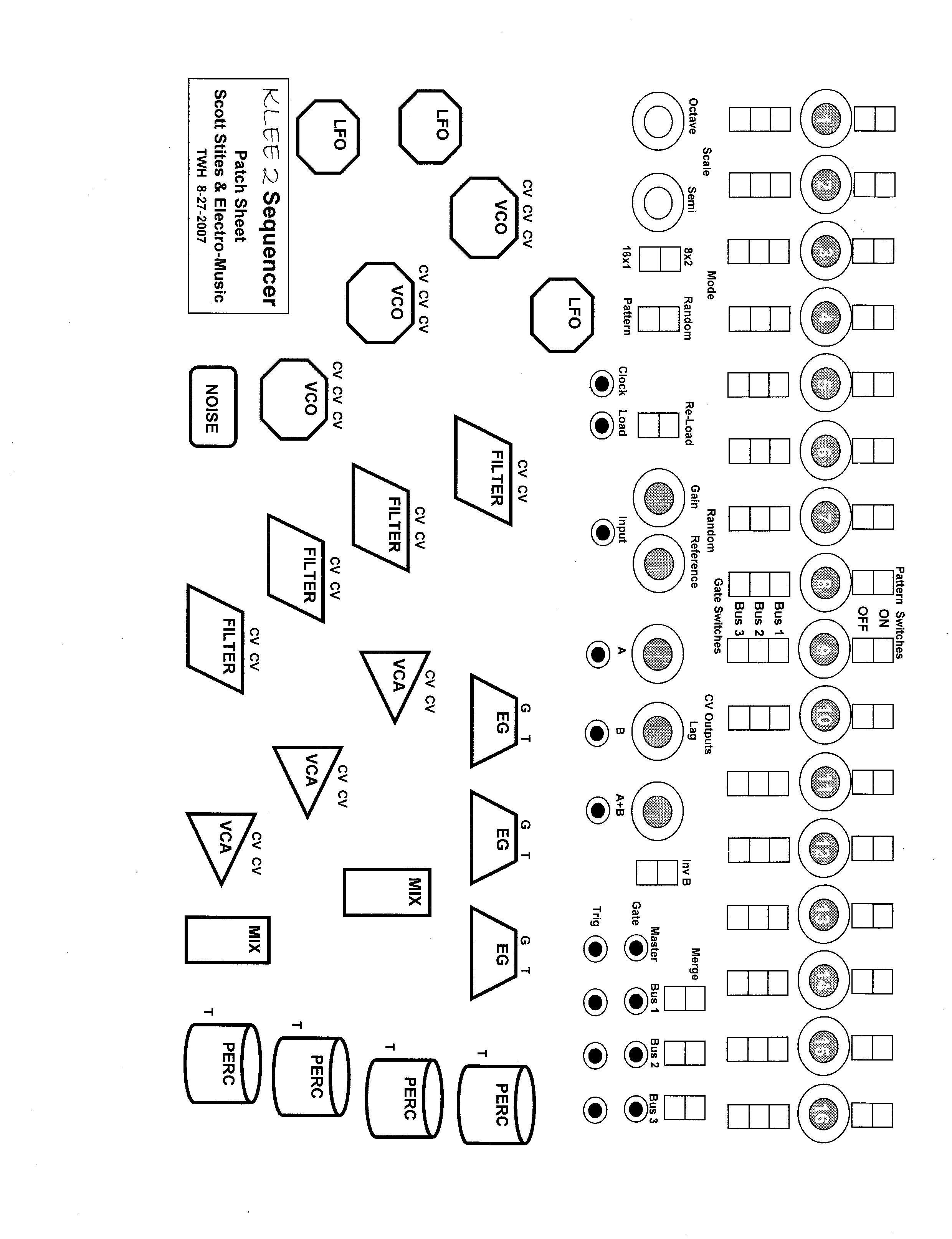

PostPosted: Sun Aug 26, 2007 11:36 pm    Post subject: Reply with quote  Mark this post and the followings unread
All,
Here is my first stab at a generic Klee 2 patch sheet. I am open for suggestions or criticism.
Regards,
Tim
