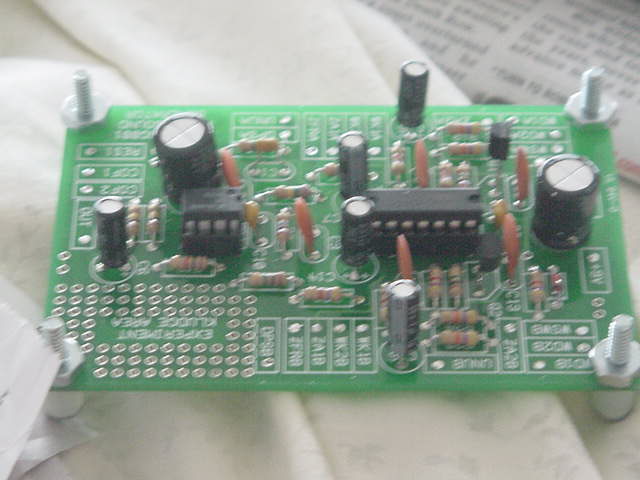

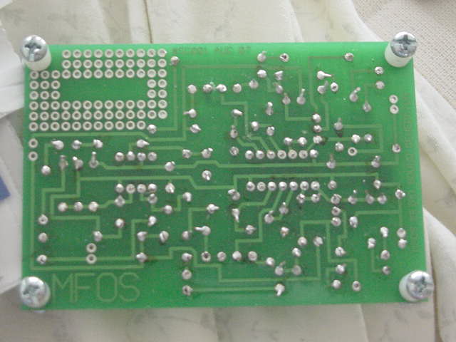

PostPosted: Mon Oct 01, 2007 12:32 pm    Post subject: Reply with quote  Mark this post and the followings unread
Hello!
Here are some pics... after unsoldering the front panel... (sigh!)...
I have some doubts regarding C1, C9 and C10 (0.1uF) because when I bought the same capacitor at Radio shack in order to build Ray's signal tracer I realized they were totally different and the capacitors supplied by Ray have so small letters on them I can hardly read them... I think it is on one side "620 FM" and "104 ESM" on the other side. However they are way smaller than the ones I bought at Radio Shack. The ones bought at Radio Shack look just like C2, C3, C4... well you get the idea!
Have a good one! (I'm not)

PostPosted: Mon Oct 01, 2007 5:54 pm    Post subject: Reply with quote  Mark this post and the followings unread
Well, looking at it compared to the parts layout on Ray's site, I can't see any problem at all. That probably means that the "fault" is in the way you wired the controls. I would suggest wiring up the power and output and have a listen, then start adding the other controls starting with the filter section, and working back towards the oscillators. Listen after every change and see if the unwanted hum turns up. You won't hurt the chips with the controls disconnected, if you did, they're cheap anyway. Hell, we gotta get to the bottom of this hey? It might sound pretty "wrong" until you have the filter controls on, but everything else is just variations on schmitt trigger astables, so they should just be quiet until you get there.
Good luck.

PostPosted: Mon Oct 01, 2007 9:08 pm    Post subject: Reply with quote  Mark this post and the followings unread
Krunkus - That looks like a good plan...
(although I'm still partial to stepping back for a few days)
Although this might not be the likely the cause of the issue, looking at the pics, I wonder about some of the solder joints....
They may be plated-through holes, but I'd still like to see good flow of the solder to the topside of the hole. There are several I'd reheat and get to flow through.

PostPosted: Tue Oct 02, 2007 1:22 am    Post subject: Reply with quote  Mark this post and the followings unread
Yeah, possibly, but I think the soldering looks pretty good overall. Ray would get plated through holes, he's pretty thorough like that. Re-heat some of the duller ones if you like Tronato, it couldn't hurt. (Well, it could, if you hold the iron there too long, but you'd know that by now. Smile )

PostPosted: Tue Oct 02, 2007 3:48 am    Post subject: Reply with quote  Mark this post and the followings unread
Uncle Krunkus wrote:
[...]I think the soldering looks pretty good overall.
For a first project exceptionally good even Very Happy I've seen fresh people coming into the workshop here doing worse, and those are supposed to have some experience.

Hello again:
The answer to both of your questions is yes. All the pots and switches are mounted on an aluminum plate.
First of all, would my not connecting for example one of the terminals of pot R25 (Weird Frequency) isolate Voice B from the filter and output?
How would you start from the output backwards? I can't see how the filter would make the noise without having any input, but then the name of the on/off switch says it all: anything is possible in the Twilight Zone! (LOL)
Please take a fast look at the schematic on the WSG homepage and confirm if yes or no...
TRO
Posts: 24585
Audio files: 309
PostPosted: Thu Oct 04, 2007 1:38 pm    Post subject: Reply with quote  Mark this post and the followings unread
No, you could temporarily remove R22 and be sure to have S4 opened, that would isolate it. To remove a resistor temporarily I'd cut one of it's wires to resolder it later - but you could of course try to get it out on one side.
