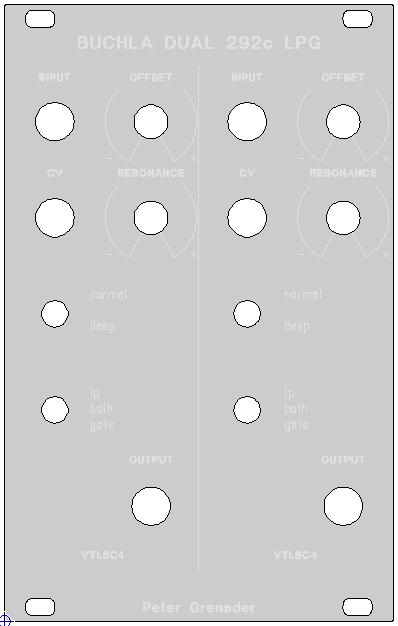

Here's my first attempt at a Euro style panel. As you can see it's basically Fonik's panel of his Chris MacDonald CV processor and Fonik's own LPG circuit with the resonance mod (Fonik, I hope you don't mind me adapting yours - if it's a problem then let me know).
Can anyone spot anything immeadiately wrong with this panel that I, as a first time FPDer, haven't noticed? I'm slightly concerned with the LPG's switches being so low down on the panel, although I think I might just get away with it.
I've used 7mm holes for the pots, but now I've printed it off on some paper I think it's going to be a tight squeeze getting alpha pots in there. I might up the diameter to 8mm to be on the safe side.

PostPosted: Mon Feb 09, 2009 7:05 am    Post subject: Reply with quote  Mark this post and the followings unread
if it was, i would not have uploaded my fpd-file Very Happy
BTW the LPG circuit is not my design, it's peter grenaders adaption of the buchla cirtcuit with the mark verbos resonance mod some nice people here in the forum optimized (see thread for dave's great PCB).
this way you simply won't be able to mount the switches vertically. i@d recommended to take the measurements from the datasheets of the components you want to use and sketch them onto the layout. don't forget to consider the mounting rails of the rack!
stay with 7mm. 8mm is far too large. the potentiometer won't be aligned properly. if you want some clearance, try 7.2mm.

Here's a link to the pots on Maplin's wesbite: http://www.maplin.co.uk/Module.aspx?ModuleNo=19412 They look the same as the ones you use on your modules, do you think they are the same? How flat against the panel do you manage to get the knobs sitting?
It would be a shame if I couldn't get the switches vertical on the panel. I've put a switch up against the paper print-out and it will be very close with the mounting rail in. Do you think it's worth making the panel a couple of HP wider to be on the safe side?

these are not the same, but quite similiar. aren't these the ones blacet uses? however, they will fit perfectly on 16mm alphas with nurled shaft. the skirt hides the mounting crew so the knob will sit VERY flat. here is a link to a large format picture of the PS3100:
http://farm4.static.flickr.com/3500/3198008550_18b0a6ded2_o.jpg
today i put potentiometers in columns and i never want to have two columns of potentiometers side by side, just to have enough clearance for operating them. for some of my older modules i did not take care of that. i wish i had (OTOH i used smaller knobs for my 2nd cabinet). take a look at my 3rd cabinet, then you will get the idea immediately:

Although I don't have an alpha pot in front of me, the knob that I got from Maplin does seem very short. I can't imagine these one sitting against the panel in the same way yours do. Maybe if I use a bolt and sit the pot away from the panel a bit? Where do you get your knobs from?
Not having the pots side by side is a good idea I think. I think I will widen my panel, although it does mean doubling the size of it! It tricky trying to make the best use of panel space without over-crowding it.

I've decided to put the CV Processor and Dual LPG onto separate panels. I've attached a new panel design for the Dual LPG. I've decided to use the slower VTL5C4 and so have included Thomas White's mod as well. Does everything look in order? I've changed the text to 1.5mm as I'm using upper case letters rather than your lower case 2mm - do you think that'll be ok?

no, your link directs to the 11mm diameter knob for 4mm shaft. i use these 13mm diameter knobs for nurled 6mm shafts: rs number 299-4957
they fit perfectly as you can see from my posted picture above (the link actually)...
very nice panel. you will enjoy it!
PostPosted: Tue Feb 10, 2009 8:16 am    Post subject: Reply with quote  Mark this post and the followings unread
i just reviewed the fpd-file.
check the datasheet of the switches you plan to use against the drilling size of you frontpanel! same applies to the jack sockets. these 8mm holes are for the cliff 1384(1) sockets.

Thanks for taking the time to review my panel. Unfortunately I can't seem to find the measurement I need on the switch's datasheet, but I printed out the panel and it seems to fit through the hole.
I'm probably going to use the Cliff S6BB/PC sockets, I think according to the datasheet I need an 8.3mm panel cut out, so I'll revise the panel accordingly.
Oh and just so I'm 100% clear - when you say nurled pot you mean like the type I posted in my last post?
