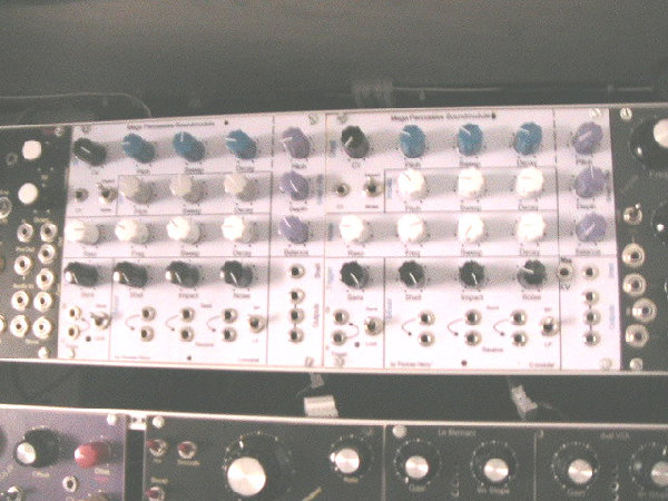

PostPosted: Wed Aug 05, 2009 7:20 pm    Post subject: Reply with quote  Mark this post and the followings unread
Hi gang,
It's been ages since I posted. Due to various impedimenta, I wasn't able to broadcast a lot of new stuff this summer as in the old days. (Five new projects never made it beyond North Mankato). So not to spin my wheels, I went back to finish up some old projects.
I finally concluded my permanent MPS unit. Here's a pic of the unit. It's the top module in my new cabinet.
It's been a couple years since I heard it on the breadboard. Wow (if I do say myself)! The noise source and filter are pretty ordinary, but the impact tone generator and ring modulator really blew/blow me away. I can sense a new song on...
Thomas Henry

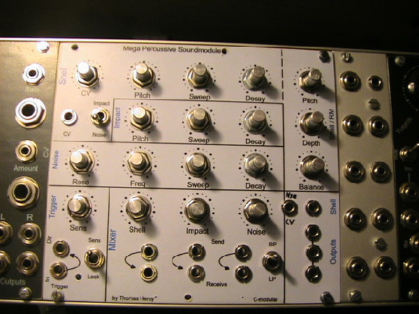

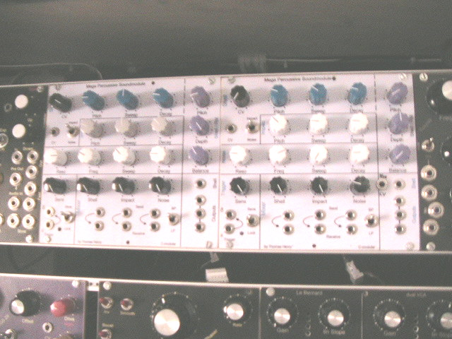

Funky40
Joined: Sep 24, 2005
Posts: 875
Location: Swiss
G2 patch files: 5
PostPosted: Mon Aug 10, 2009 9:06 am    Post subject: Reply with quote  Mark this post and the followings unread
My MPS Eurorack panel.
messed it up with that additional Noise CV socket
thanks again, i like it !
for best adjustments i suggest to use "something" Multiturn. Trimmers for example instead of pots.
Especially for those who like to build several units.
Shell Pitch and RM pitch have lots of sounds within very small amounts of turning the Knob. ( Or the expensvie multiturns )
also Impact pitch could be donne multiturn, but not really important.

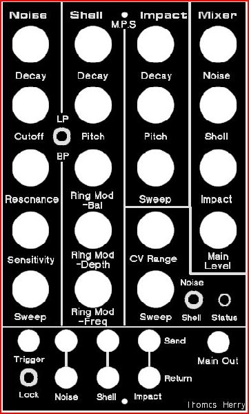

Hey yall
Just looking for some feed back on my panel design for the MPS. Thanks to all others who have posted theirs as inspiration.
I'm building two of these probably on blue anodize in a nice wooden casing. The size of the holes is actually representing the size of knobs, jacks etc. to give me an idea of the spacing, not the actual size of holes.
The main thing i've considered changing is dropping the send/receives. Any feedback would be great

hobgob_inc
Joined: Jun 09, 2009
Posts: 46
Location: Australia
PostPosted: Sun Aug 23, 2009 4:58 pm    Post subject: Reply with quote  Mark this post and the followings unread
Not sure how to have the image showing on the page....
Edit: State Machine added image 8-27-09 .... saved the image in PDF as JPEG and used as attachment. The JPEG will automatically show up as an image in the post.
