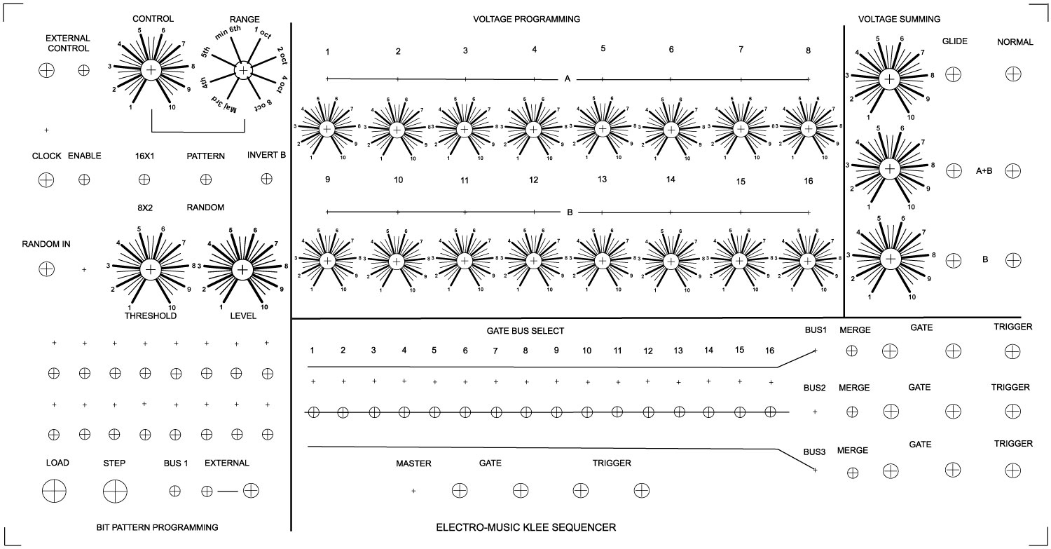

Here is a Klee panel design in dotcom format that I worked on yesterday. There are still some alignment and spacing issues to work out but I thought that I would post it anyway to see if folks thought it was too confusing. The idea was to break it up into programming chunks instead of just stages. Not sure if this a practical approach but it seems to make sense to me after reading the operation manual.

I love this design!

So does it all make sense to you? It will take 32 more LEDs to show what stage is active in each programming section.
Thanks so much for your input. I am going to shift it around a little and see what happens.

I like this look !! I have one piece of advice. In the RANDOM IN section, I would replace REFERENCE with THRESHOLD. Just seems more descriptive to me. Otherwise, everything is very logically laid out and has a nice work flow. Nice job Very Happy
That's a good tip. I what to get the layout a good as possible because I am thinking of having this silkscreened for me which is a relatively big investment. I've printed a few of my own panels before, but this is a little beyond my skills.
I also had to shift a few things around for the mounting holes. Can't forget those. (again)

I was going to buy a blank dotcom panel and have it printed, but after making some phone calls I think that is going to be too pricey. The local shops are not interested in one offs or even small runs. So I am looking into having the screen made professionally and printing it myself. I have not gotten a firm quote yet but it should knock a few hundred dollars off of the price.
I could print more panels if anyone was interested with the understanding that I am not a professional.

That would be incredible. Please let me know what you would need to help make it happen. I have been working on the alignment of everything for the negative. There are still a few things to get just right.

Oh yes, such a big investment in time and money, check two or three times. The mistake I personally have made in the past is mounting things too close to a panels left and right edges. If you intend on mounting your panel into a 19" rack, you can easily have components hitting the mounting rails.
Just friendly advice ......... Wink
