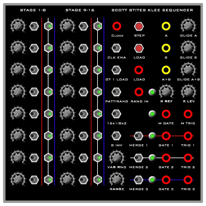

Here is my Modcan design. I'm using Push/Pull pots for the pattern switches.
Klee in Modcan

PostPosted: Thu Nov 13, 2008 4:17 am    Post subject: Reply with quote  Mark this post and the followings unread
that's so cool, man. good idea. Laughing
and the panel looks amazing of course. i am curious to see the finished klee...

PostPosted: Thu Nov 13, 2008 6:48 am    Post subject: Reply with quote  Mark this post and the followings unread
That is a beautiful thing. I've always liked the modcan look.
I'd be very leery of using the push-pull knobs though - it's way too easy to detune the pots when pushing or pulling them. If attempting tonal (in tune 12 step per octave) type music, the pot settings need to be very precise, as any small error affects all (or at least a lot of) the pitches. Of course, if that idea is foreign to you, then go for it! But if I were you I'd add the additional width for another set of switches.
fadeddata

PostPosted: Thu Nov 13, 2008 3:57 pm    Post subject: Reply with quote  Mark this post and the followings unread
Good point. Typically if I'm worried about that I would go through a quantizer of some kind. Do you think that would mitigate the affect of me accidently moving the knobs when pulling?

PostPosted: Thu Nov 13, 2008 4:18 pm    Post subject: Reply with quote  Mark this post and the followings unread
IMHO I think that it will not be very useful.
There is the point of move the knobs accidentally.
Also I think that a row of switches is more clear and intuitive to see the pattern .
The Pattern is a parameter enough important to have its own and dedicated controller.
It is easy to add the pattern switches on your design.
Regards!

PostPosted: Thu Nov 13, 2008 6:30 pm    Post subject: Reply with quote  Mark this post and the followings unread
Maybe push button LED's? I'd much rather not add another panel width.

PostPosted: Thu Nov 13, 2008 6:55 pm    Post subject: Reply with quote  Mark this post and the followings unread
Cha Ching! There's the ideal answer - pushbutton leds! Of course, you'd want multicolored ones, for determining the button state. Hmmm...
Yes, I really think you might want to rethink the push/pull pots - even with a quantizer, you might get more "randomization" than you want. And I've found that I'm flipping the pattern switches a lot, and often pretty fast - the opportunity for accidents is wide open.

PostPosted: Mon Nov 17, 2008 8:17 pm    Post subject: Reply with quote  Mark this post and the followings unread
Ok I'm thinking of using NKK M2100 toggle switches (http://www.nkkswitches.com/pdf/M2100.pdf) for the gate bus switches. That allows me to toss out the LED indicators and put the pattern switch there. More expensive but it gives a great visual indication of which gate bus it's on.
What do you guys think?

PostPosted: Mon Nov 17, 2008 9:09 pm    Post subject: Reply with quote  Mark this post and the followings unread
That looks great. How much do those things cost? (and if mousers switch prices are any indication of a trend, buy them as soon as possible)

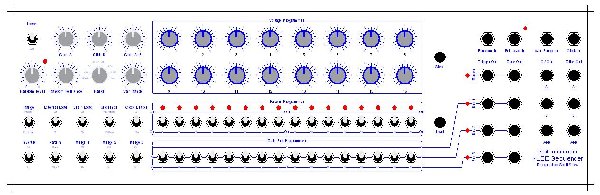

GraeT
Joined: Sep 23, 2008
Posts: 11
PostPosted: Sat Mar 07, 2009 6:22 pm    Post subject: Euro Rack Klee panel
Subject description: My Klee panel design to suit my Euro Rack
Firstly, I want to acknowledge all the previous people who have posted their panel designs here; there are some truly beautiful designs and I have borrowed various ideas from a number of them.
My design considerations were that I wanted to group the controls logically and try to keep patch cables away from pots and switches.
The pattern and gate bus switches and voltage pots are grouped in the center, plenty of room around the manual load switch, switches and other pots on the left and all the jacks on the right.
The panel was designed in a CAD program and re-done in FPD to order. I will be using a laminated paper overlay for the text and graphics.
 Filesize:  120.63 KB
 Viewed:  513 Time(s)
 Filesize:  120.63 KB
 Viewed:  488 Time(s)
sduck
Joined: Dec 16, 2007
Posts: 459
Location: Nashville
PostPosted: Sat Mar 07, 2009 10:41 pm    Post subject: Reply with quote  Mark this post and the followings unread
Looks fabulous! I'd switch the step and load buttons If I were you - the load switch gets a real workout, and you want it front and center, but you only use the step switch when tuning the knobs.
