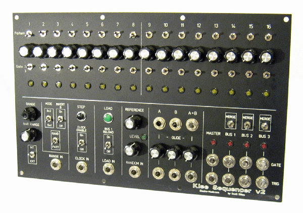

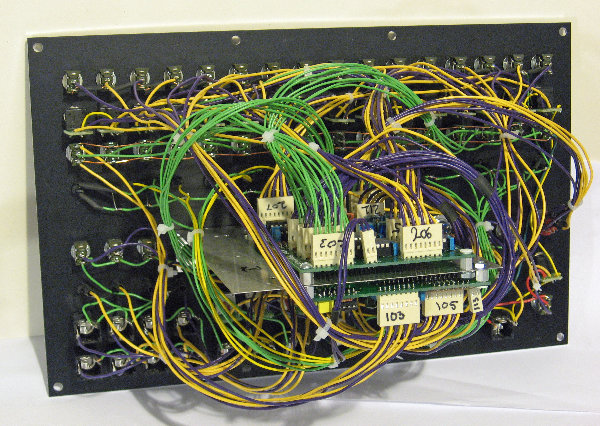

PostPosted: Tue Aug 12, 2008 7:58 pm    Post subject: Reply with quote  Mark this post and the followings unread
So I finally finished my klee, and am happily playing with it. Took a few pics before locking it down in the cabinet - it already got matrixsynthed, but thought i'd post them here too for posterity.

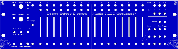

PostPosted: Mon Sep 29, 2008 4:05 pm    Post subject: Another Fonik/Mono-Poly style Klee Panel Reply with quote  Mark this post and the followings unread
Many Thanks to Fonik and Mono-Poly for coming up with this layout. I've ruthlessly adapted it to match up with my parts as described in this post (amended based on recommendations following that post): http://electro-music.com/forum/post-180647.html&highlight=#180647 including making enough horizontal room for my chosen slider caps, etc. One more printout and spot check now that I'm back at home, then ordering it tomorrow Smile

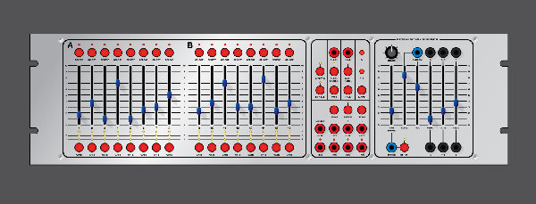

Just made a revised edit of my panel..
Went all in on the buchla look-a-like layout..
Not really 100% sure about it though. Since the use of tact-switches instead of normal switches will just contribute to like 200 more wires (Plus a few µC that controls them aswell.) But hey - why make stuff easy?
Edit: Exchanged the range slider to a rotary switch - as it's supposed to be..

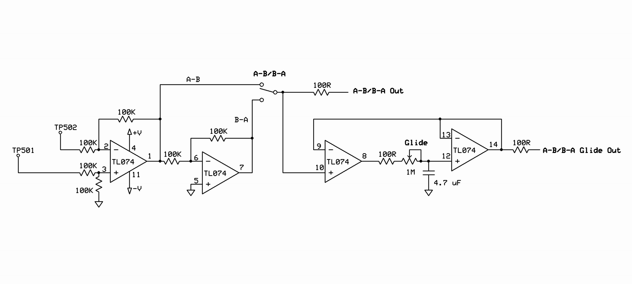

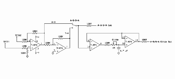

BTW, if one wants to pimp a Klee, here is something that would really knock it into orbit with barely any parts expenditure, though it would claim some more panel room.
Klee puts out A, B and A+B. Why not A-B? Or, its inverse B-A? This creates an entirely new *unique* voltage output. Here's an example of an implementation - this one uses a switch to select between A-B and B-A, and has its own glide circuit so it's uniform in control with the other voltages. Note, I think the cap would be best unpolarized, because this particular voltage would go below 0V, unlike all the rest of the Klee voltages. This voltage would follow all the rules of the A+B voltage, it just would be totally different - but yet related to all the other voltages in a very Klee-like manner.
This is one implementation, You could use a single TL072 and have both outputs simultaneous with no glide circuit, or use a TL072 for the differential amplifier and inverter, and use a TL074 to make two glide circuits, one for each output. That's if your panel is the size of a mac truck. Laughing
Believe, if I hadn't drilled my panel and had room, this would be the first thing I'd put in if I were to pimp my Klee.

Pimped out AB voltages
