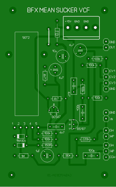

PostPosted: Fri May 04, 2018 4:17 am    Post subject: Reply with quote  Mark this post and the followings unread
I want to etch a mean sucker vcf but I don't understand part of the schematic I have outlined in pink on the schematic (pictured under the layout below):
Specifically:
1. What does "Rx" mean? (alternately a fixed resistor?)
2. What is the dotted line between 'Rx or 1m Lin' that leads to 'input'. How do I connect this in a circuit?
3. What do the two slashes on either side of 'Rx 220k' after 'input' mean?
The pcb by Etaion (see green layout below for ease of reference) seems to match the schematic other than the 350r resistor which is for +15V and I will run it on +12V with a 275r resistor. If anyone can see any other differences please let me know.
Thanks very much.

Ayab
Joined: Oct 27, 2015
Posts: 186
PostPosted: Thu May 10, 2018 5:21 am    Post subject: Reply with quote  Mark this post and the followings unread
I realise that this probably means either 1m lin potentiometer or R 220K but can someone please confirm.
Posts: 24670
PostPosted: Thu May 10, 2018 6:13 am    Post subject: Reply with quote  Mark this post and the followings unread
That is my interpretation too, select one of both options.
Ayab
Posts: 186
PostPosted: Thu May 10, 2018 7:08 am    Post subject: Reply with quote  Mark this post and the followings unread
Thanks Jan
As you think so I will use 1m linear pot instead of 220k
Appreciate your help and will let you know how it works out
