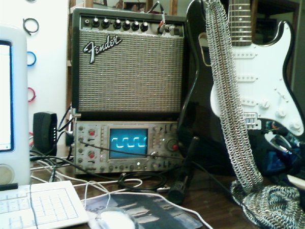

Does homemade gear count as new gear? Sure it does!
Pictured below is my setup minus the, um, new gear which is on the other table. You can, however, see the jittery waveform of a Theremin wiggling it's all get-out at 25 kHz on the scope. The Theremin will eventually get mounted on the guitar so I can wave my hand over it and create effects that way.
Some gear-head items to note: eMac to the left running ChucK guitar processing software that I wrote, Squire Strat with custom-routed handle and chainmaille strap plus gravity/acceleration sensor, osillyscope with custom 1/4" plug to BNC cable for viewing guitar waveforms, and rockin' Fender Frontman 15G amp.
I hope to get a Y-cable someday soon so that I can have the scope monitor the audio at all times, but for now it's keeping an eye on the Theremin prototype.
Gear + Theremin Waveform
