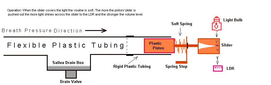

To add dynamic control for volume and tremolo variations, I thought up the following idea:
