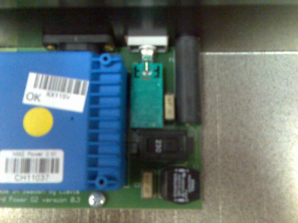

I just changed the voltage on my G2X from 110v to 220v, very easy to do and better than having a step-down transformer.
Having removed the 6 screws along the back and one towards the front of theeach side ( not the two rear sides because they act as hinges ) and also 2 screws on the bottom, th elid hinges up towards the rear.
Indside you will see the PSU board, ( it has a big square blue switch mode module on it ). On that board is a big black switch clearly marked, just flick this to your required voltage.
Don't worry about 110,115,120 or 220,230,240 , so these PSU's can work within 10% of the supply voltage without a problem.
The fuse rating for 100v is 300mA, for 220v it's 150mA. ( for 220v it's OK to leave the 300mA fuse in, at that current it will still adequately protect the PSU circuit.) They are standard 30mm quick blow fuses.
You can see the voltage switch here, it's a big black plastic slider switch with the selected voltage printed on it. A bit fuzzy, sorry, but you can see it OK.

I bought my G2x in New Zealand and just moved to the States. On the back of my G2x it specifies 230V / 125 mA fuse. Now that I am in the states, can I just switch the powerplug and use it as it is, or do I have to change the fuse and/or flip an internal switch before I do that?
Posts: 24373
Audio files: 296
PostPosted: Thu Feb 12, 2009 11:43 am    Post subject: Reply with quote  Mark this post and the followings unread
The Enright House wrote:
[...]or do I have to change the fuse and/or flip an internal switch before I do that?
Wasn't NZ using 110 / 115 Volts as well thinking
Anyway, I'd open the synth to check if it's set to 220/230 or to 110/115 volts ... for the US it should be set to 110/115, and when it was set that way already you could just use it ... and otherwise you'll have to change it.
When it's been set to 110/115 I'd advise to make a clear mark about this on the back of the synth indicating so ... it's a bit confusing otherwise for a possible unknowing other user ...
Also I'd check the fuse to actually have the value it should i.e. 250 or 300 mA for 110/115 Volt.
steve m
Joined: Apr 15, 2008
Posts: 19
Location: australia
PostPosted: Thu Feb 12, 2009 1:55 pm    Post subject: Reply with quote  Mark this post and the followings unread
New Zealand power is 240v, just like Australia and UK. So if your synth was setup for 240v you need to change it for 110v as follows:-
Open up the Synth and change the voltage selector switch on the PSU board to 110v. It's a big black switch sat next to the big blue power supply module, you can't miss it. Because the synth will be running at 110v it will use 2 x the current, so check the fuse and if required change it for a 300mA one, other wise it may blow with the extra current. If it's already 300mA then it's OK.
When you come back to NZ, just flick the switch back to 240v. Laughing
It's as easy as that. No need to use 'powerpacks' or transformers.

Thanks everyone. Opened up my G2x yesterday and flicked the switch (totally easy - as you all said it would be!). Just have to find a proper fuse now. Radioshack etc doesn't carry slow blow fuses under 500 mA. Will have to look for one tomorrow.
