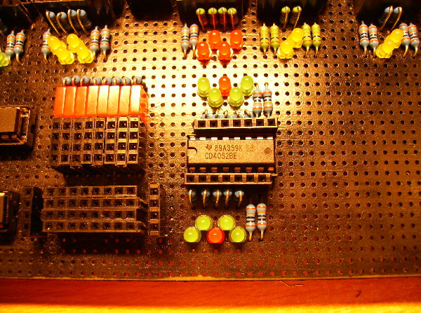

PostPosted: Tue Oct 05, 2010 1:57 am    Post subject: Reply with quote  Mark this post and the followings unread
This new 4052 is amazing for making fast switching interesting patterns. This is 4053 powered by 2 dividers and 2 fast clocks for the ABC, some weird cv from the 4069 all going into the 4046 with a touch of reverb, that's it! It gives some great control while staying in beat, very important for live patching.
i just got some 4052's in the mail- the 2 ins 4 outs right? Did you just wire each pin to a jack mostly? Or did you put pots on each of the outputs to vary the voltages?
the 4069... is that wired as an LFO?
and the 4046 i assume is wired up as a vco.... gotta get me some of that next order.

PostPosted: Tue Oct 05, 2010 3:10 am    Post subject: Reply with quote  Mark this post and the followings unread
It's actually a 4 bit version of the 4051. You get two 4:1 multiplexors, 2 control bits(A and B)and an inhibit input.
I added a picture to show how I build it, just wired all the pins straight to headers, the lay-out on this ic happens to work really well as it is.
Yes and no Smile. It is wired as the scott gravenhorst triangle LFO but I left out the limiting resistor so it also goes into freak out audible range when the pot is turned all the way. Im not sure anymore but that might be what happened in Teknologic.
Yup, great IC. I have one on my breadboard for weeks now and it's just a great allround module. It works nice as a VCO but I also use cv on pin 7 in between the resistor and pot with nice freakish results. That's the thing with these cmos ic's, use and abuse them in every possible way and there are some cool hidden gems to be found Smile.
