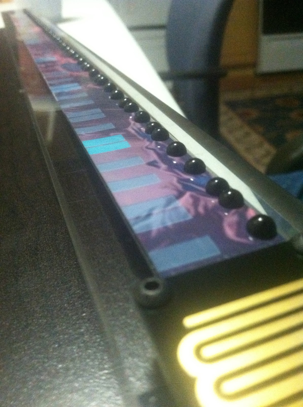

Just recently added another physical mod to my Eowave Ribbon... I added physical half pearl bumps... sort of like the note references on the Martenot.
The pearls are really nice. You can use them for note reference but also with a slight angle change you can ignore them and just slide around easily up and down the ribbon.
And as an unexpected bonus, the pearls also make a nice reference to feel exactly where the center of the ribbon is along the length. That makes it possible to play with out even looking at it and easier in general even if you do.
I got these self adhesive half pearls at the craft/hobby store Michael's and they are cheap and so far not falling off.
Still working on the ring controller, but this set up plays so well with the pearls that I'm starting to think the bumps/note references may be the better thing to borrow from the Martenot design over the ring.

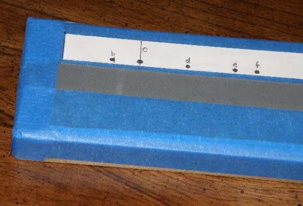

Here is the sensor used in the Eowave Ribbon, which is what I modified. I think it's that softpot that is out there and even used with the Doepfer ribbon controller. This image shows the sensor under the Ribbon, but here mounted on something maybe sightly wider than the Ribbon instrument but close.
On my mod, contact with the pearls doesn't actually touch any sensor. My finger just rests lightly if at all on the pearl and my finger tip presses down in the very center of the keyboard image (which is right where the bottom of the printed little keys is).
The width of the ribbon's printed area is 7/8ths of an inch and the center 3/8ths of the width is were the sensor sits beneath the printed part.
With it like this I'm only getting sensed if I'm nicely right in the center of the width, which turns out was another great reason for the pearls and the printed keys... the key edge image shows me not just where the note generally is, but where the ribbon center, the sensor is. Also the feel of the pearls similarly gives a note reference and a feel of the center.
I do find myself not looking all the time, and it does come down to the ears. Though I have a lot of more practice to do on it really. For sure, the pearls and image turn out to be an aide to get there but intonation comes down to the ear, as you say. Especially since any fixed printing on a ribbon, Martenot or any contiuum is pretty much a well tempered clavicord when it comes to intonation. Each note needs to be adjusted slightly within the key of the music.
Also... I like very small notes widths on my Ribbon, which makes large movements do much more to the pitch. I love this for what it does to vibrato and dives and rises, but it does mean I need to really monitor the pitch more carefully. To contrast this, on my DIY Martenot ring controller I'm having key lengths probably to end up about a half an inch, which is at least double what I use on the Ribbon.
I'm still just playing the Martenot Ring/loop a lot before committing to a key size, just so I can have it just right where it works best for me.
