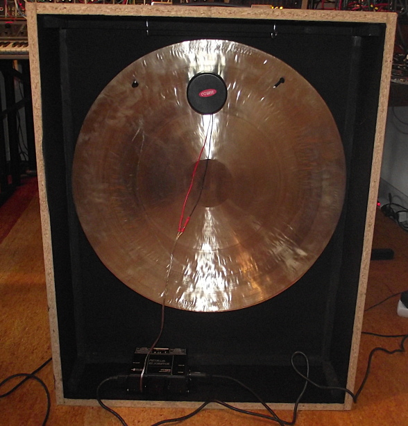

Hi friends
Yesterday I received the Eowave Metalik Resonator, an ideal complement for my ondes Martenot.
Here are some photos of the resonator. Note that the Resonator is normally sold by Eowave with a tolex finish for the cabinet but I asked them send me the raw cabinet such that I can cover it myself with wood veneer matching that of my ondes Martenot
Seen from the back, one can see the compressor motor attached to the Tam foil in its upper part, and the 50W power amplifier on the bottom

Frontview : the MiniBrute on the left gives an idea of the size of the resonator. It's the bigger model.

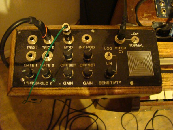

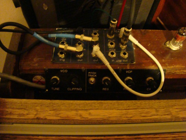

PostPosted: Wed Jun 12, 2013 3:16 pm    Post subject: Reply with quote  Mark this post and the followings unread
Anyone have a suggestion for a transducer for a D.I.Y. version? I really know nothing about transducers, so even specs to look for or places that carry a selection would be very helpful. My controller project has made good progress,everything is tested and I just need a few more pieces of wood to finish it.
tojpeters
Joined: Feb 04, 2013
Posts: 22
Location: cali (far north)

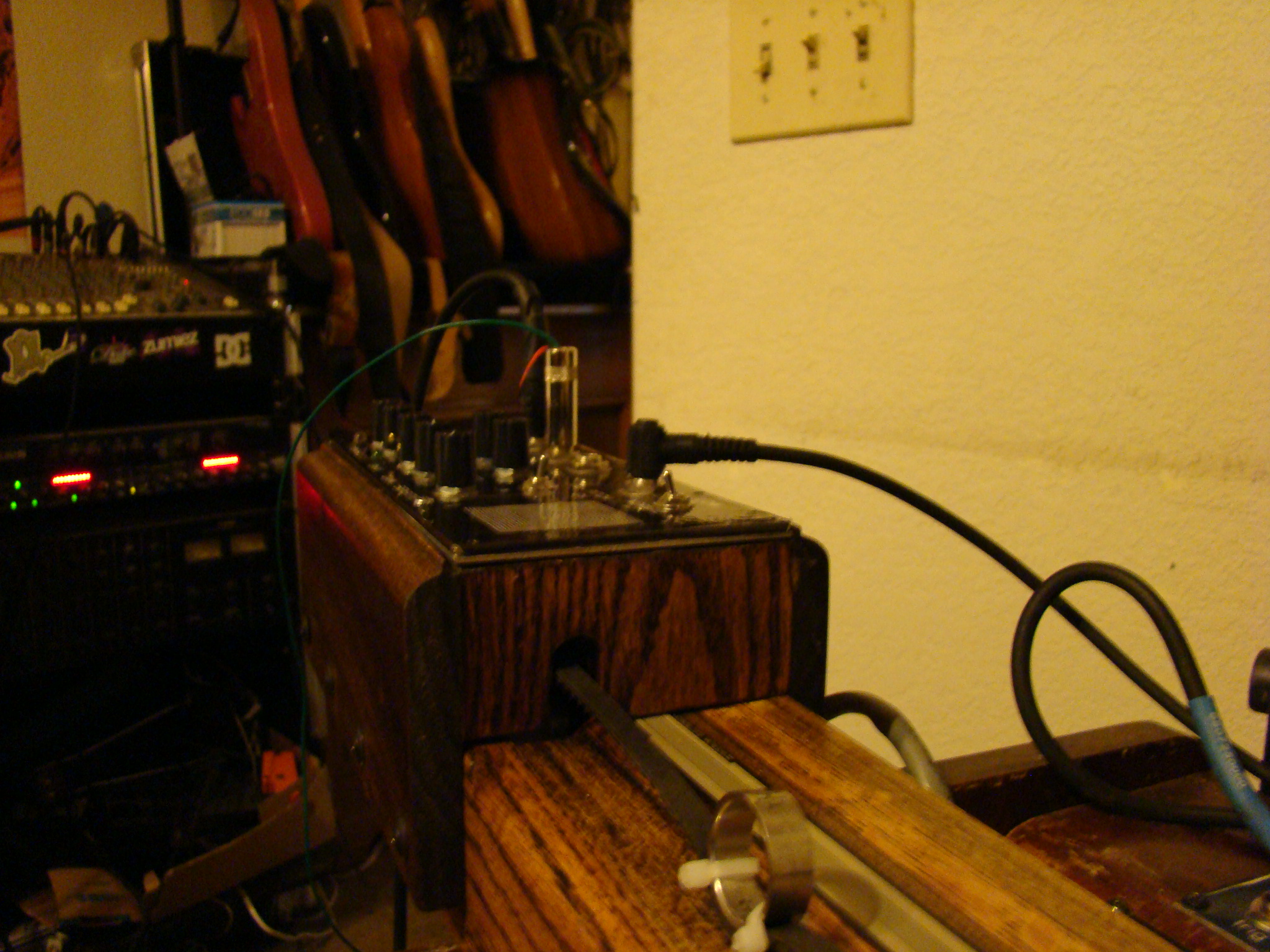

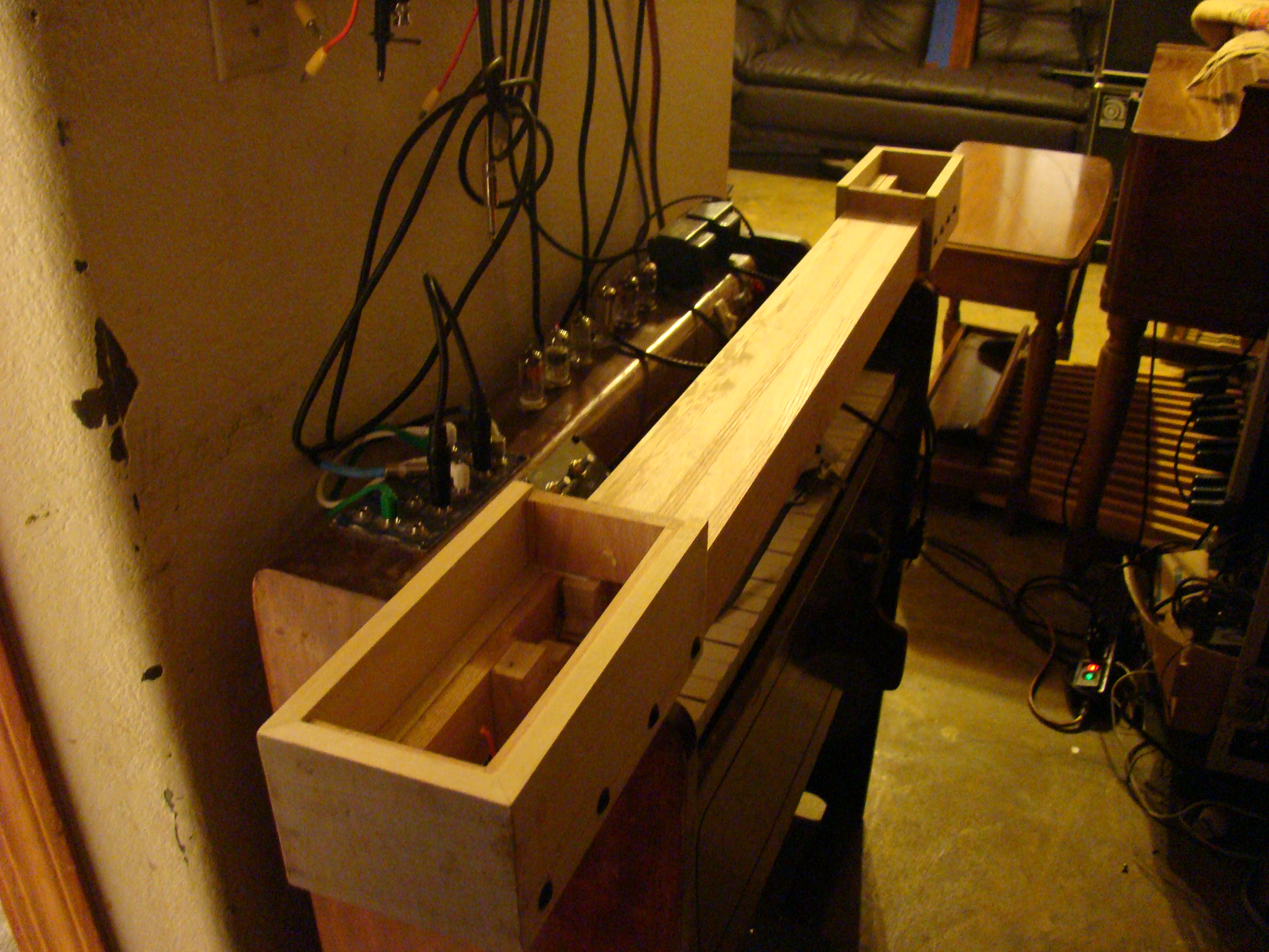

PostPosted: Wed Jun 26, 2013 7:05 am    Post subject: Reply with quote  Mark this post and the followings unread
just need to sand/finish the wood, replace a pot that i managed to destroy, and build a couple A/R generators for the right side control panel. everything is tested, just need to put it all together. I found the transducers i need, i need a gong now. I'm also mounting a couple of them on the soundboards of the reed organ this is built on. Also need to re-tune the keyboard as i switched from +/- 12v to +/- 15v. Probably wait on that as it only does about 20 keys and i think that can be improved. i need to be able to hold the voltages [0-12VDC and 0-150VDC)after key up until the next key down to really make it nice.
 Filesize:  976.07 KB
 Viewed:  1181 Time(s)
 Filesize:  954.17 KB
 Viewed:  1156 Time(s)
tojpeters
Posts: 22
PostPosted: Wed Jul 17, 2013 4:13 pm    Post subject: Reply with quote  Mark this post and the followings unread
everything works. now i need to add position markers. will add 2 ADSRs in the future.
 Filesize:  1003.09 KB
 Viewed:  1082 Time(s)
 Filesize:  942.03 KB
 Viewed:  978 Time(s)
 Filesize:  932.29 KB
 Viewed:  1048 Time(s)
 Filesize:  934.91 KB
 Viewed:  982 Time(s)
