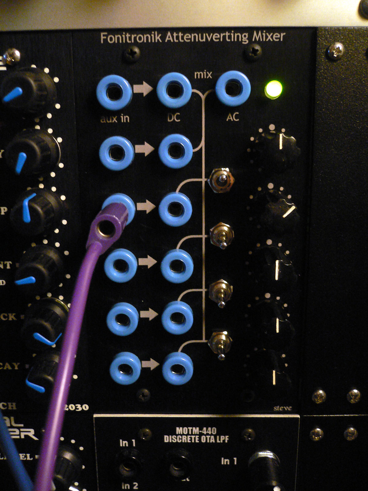

I finally got one of my attenuverters built. It's a frac format. Both the AC and DC coupled Mix outputs are brought out to the panel. A sixth "Aux" input is tacked onto the mix summing point through another 47k resistor. Inputs 2-5 have toggle switches to selectively add them to the mix. The LED's a bipolar red/green. The panel started out as one of Blacet's blank panels and a local shop lasered the graphics for me.
 Filesize:  529.56 KB
 Viewed:  209 Time(s)
 Filesize:  311.6 KB
 Viewed:  195 Time(s)
PostPosted: Sun Mar 15, 2009 4:28 am    Post subject: Reply with quote  Mark this post and the followings unread
Shocked
man, what a nice build. great module.
i't liked to ask you if i could post this picture on my site?
BananaPlug
Joined: Jul 04, 2007
Posts: 307
Location: Philly
PostPosted: Sun Mar 15, 2009 7:26 am    Post subject: Reply with quote  Mark this post and the followings unread
Absolutely! Glad you like it. Thanks for great PCBs, docs, etc.

I would like to have more of this utility mixers,
but with a precision voltage referenze for the CV offset.
Seems to be a need when offsetting VCOs
PostPosted: Sun Mar 15, 2009 12:52 pm    Post subject: Reply with quote  Mark this post and the followings unread
the offset function was originally meant as a goody, not a major feature of this module. the offset voltage changes whenever you turn one of the processing potentiometers.
nevertheless one could improve the perfomance of the offset function or stabaliue it by replacing the two resistors of the voltage divider creating the 7.5V by a 1k resistor and a Zener Diode. this has been entioned by serenadi (member here), i implemented it and will post the details soon.

This new "Lunar Experience" module looks suspiciously similar...
http://www.lunar-experience.com/525.html
http://www.casia.org/modular/
PostPosted: Fri Apr 17, 2009 1:48 am    Post subject: Reply with quote  Mark this post and the followings unread
i met gerd at the musikmesse and we have had a short talk. he does this stuff for decades as a hobby and has recently been talked into selling modules, IIRC. his website does not reflect his modest and humble character, i believe.
i would say, his attenuverter does not mix signals, has no optical indication and no DC-mode. his mixers inputs are not normalled to a reference voltage.
i still believe the fonitronik attenuverting mixer is a very versatile module - if it ever would come to a 3rd run, i would improve and add some features (real stable reference voltage, on/off switches for each channel).

His first input (and by way of chaining, all the others) is connected to a +10V reference.
