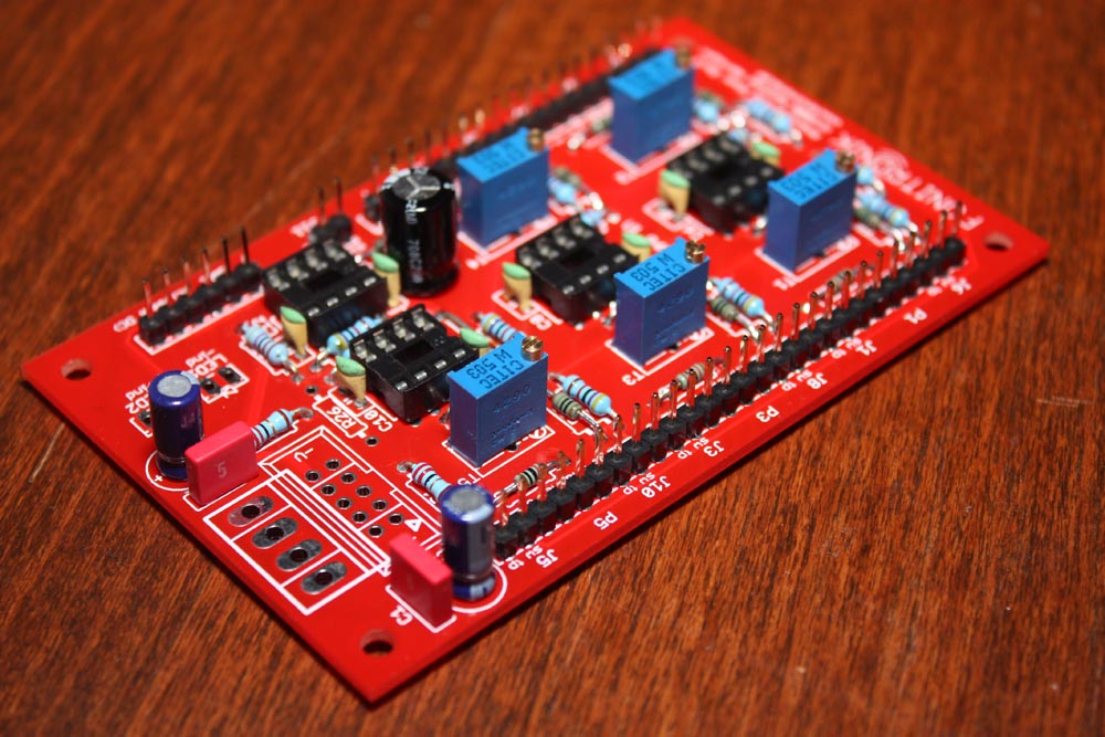

nice shot!
these are precision ceramic disc caps? zero tolerance? i don't think you will experience any problems. leave them, they're looking quite good.
these are just filter caps to keep the voltage rails clean, so as said before, it does not matter IMO.

PostPosted: Wed Oct 01, 2008 6:26 am    Post subject: Reply with quote  Mark this post and the followings unread

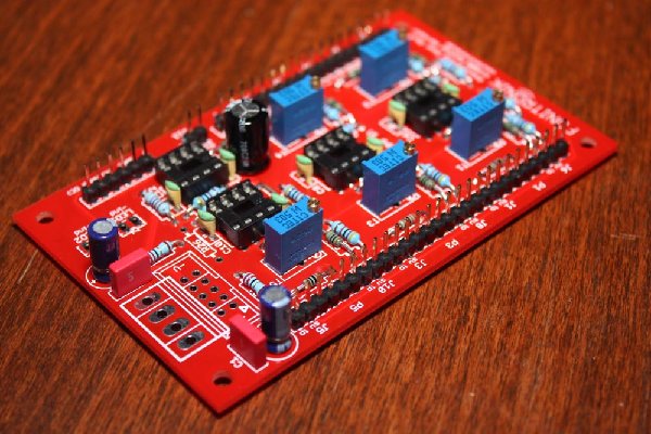

Since this is my first module, I have a couple of questions regarding connectivity...
The power source connector, there appears to be two, is this for choice, or do both need to be there? Is there a standard for modules? And what are the part numbers?
Also, I have soldered pin connectors for the panel components, is this the standard procedure? I need to know what sockets I can buy to connect to the panel components to them?
I have included another picture:

PostPosted: Wed Oct 01, 2008 6:50 am    Post subject: Reply with quote  Mark this post and the followings unread
these connectors are to be used alternatively. the 4-pin connectors is used by MOTM and Blacet (AFAIK), the 2x5-pin ribbon connectors are used by Doepfer, Analogue Solutions and Analogue Systems.
for the .156 grid 4-pin connectors search for molex or tyco .156 (farnell stocks them), for the ribbon connectors search ...err... ribbon connectors?
actually i indended to use crimped connectors. they need to be stackable. i like your idea of using simple pin connectors, though.
it would be good if others shared their practice here. i just try to use what i get at my supplier. you mileage may vary...
take a look at this picture below. this is a module i used those crimped connectors for. for the attenuverting mixer you need stackable connectors, like the two 3-pin connectors with blach caps (picture bottom, middle)
