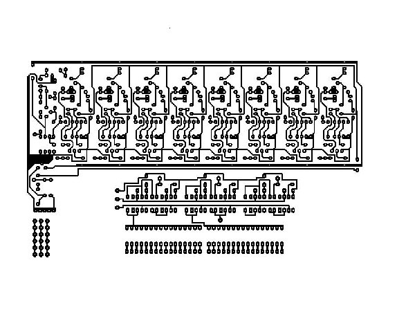

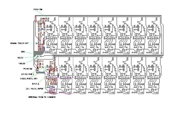

ok here are the re-worked layout files and everything else.

Found a labeling error. For the programmer portion of the layout, the resistor connected to the pin 6 of the rightmost IC is actually 330k and not 100k as listed on the layout.
Still looking at the programmer, the other portion of the layout contains a 150k in the upper left corner. It's missing the +12 connection that T4, 150k and 10k share.
I haven't finished the rest but this is what I found so far. |
akrearke
Joined: Sep 08, 2008 Posts: 53 Location: US
Posted: Wed Sep 30, 2009 5:52 pm Post subject:
you are correct. just draw a trace from the 150k/10k junction to the uppermost trace and you have +voltage. as for the 330K resistor, you are also correct. easy fixes, but could have presented serious problems.
i hope everyone will post their own findings.
I downloaded some pcb layout software, we'll see what comes about in the future... |
