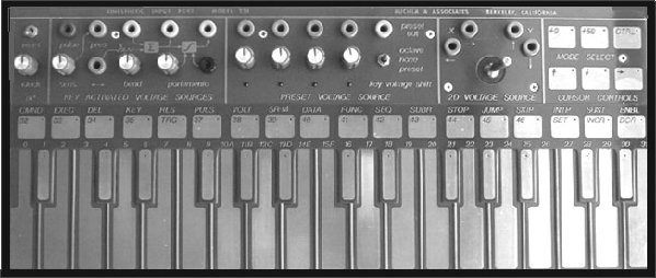

Just beautiful!
Well, at least you have had the opportunity to play with a Buchla - I don't even think are any in my country...
C _________________ Some Rubber Stamp Sound Effects - and other sound effects |

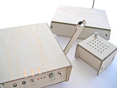

Check this out; Posted on matrixsynth: this guy is building synth modules with cut cardboard enclosures, and most interesting, control surfaces from "special conductive paint"!
This is the control surface I've been looking for; I'm imagining a plastic Shaeffer panel, with key sized etchings that could be filled in with this silver conductive paint. This would be so freakin cool!
http://noisedesign.blogspot.com/
http://www.youtube.com/watch?v=kYAyX5DWkdo
http://youtube.com/watch?v=9wU7DUODM5Q

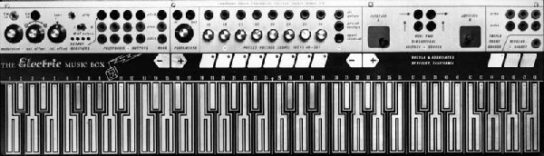

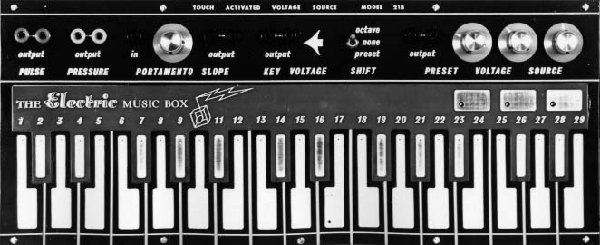

The shape supposedly isn't too crucial. I doubt if many have been tried though, I have seen only circles, ovals, squares, and rectangles of various sorts. Photos of Serge pads seem to indicate that they are only circular pads which are separate from a large ground plane. So there's a small solder pad which comes off of the touch plate for affixing a wire behind it, and a single ground connection for the rest of it.
The Buchla keyboards appear to use several rectilinear patterns. I have seen keys which are nested "U" shaped figures, perhaps alternating signal and ground. As I recall now, pictures of the Music Easel had shown touch plates in the shape of miniature piano-like keys. Here are some pics.
I like how Buchla expanded the idea with more touch button surfaces and psuedo ribbon controllers. I don't know anything about RF electronics but it appears that there is a lot we can try here.
