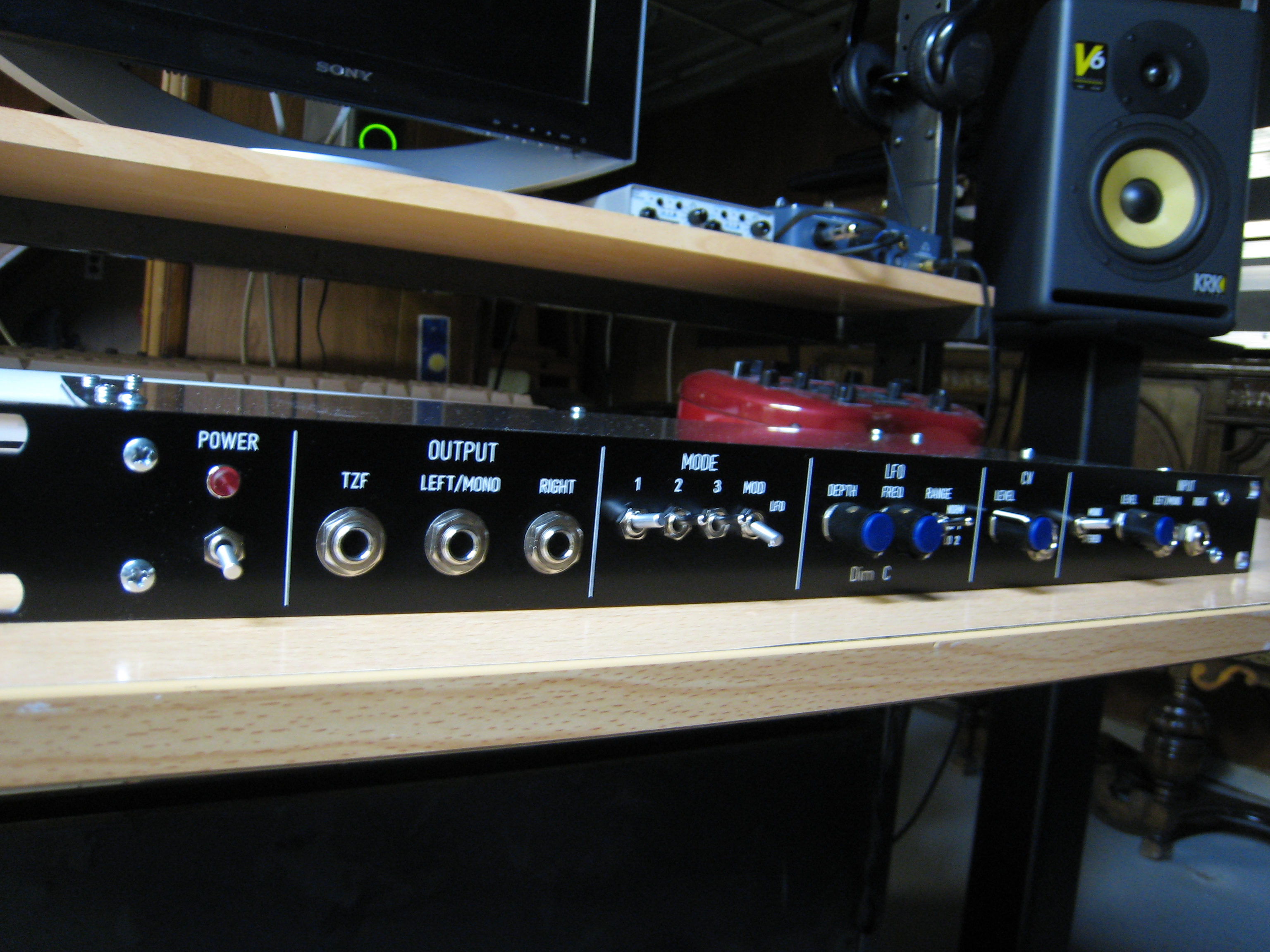

PostPosted: Tue Nov 25, 2008 9:09 pm    Post subject: Reply with quote  Mark this post and the followings unread
Finally got my panel and got it housed in an enclosure. Of course the day after I submitted my order to FPE I realized I'd left off holes for the manual LFO freq & depth switches. Could drill them myself and probably will at some point, but to be honest it's such a tight fit on the panel as it is that I'm not sure where they'd go. I'm posting a few photos. Based on Scott's panel with few changes.
The board sounds fantastic, by the way! Soooo good. The CV seems to work really well too - played it with the LFO on my Moogerfooger CP-251 for a bit. If I weren't pressed for time with leaving town tomorrow I'd get some audio up. I'll try next week. Thanks for such a great project.
I am having 1 problem though. I'm getting a loud pop when turning it on & off. Could it be the power indicator lamp I have wired up? It's a lamp, not an led, but still wondering if that could be the culprit. For now I'm working around it by just powering it on & off while my amp is off. Any thoughts?
