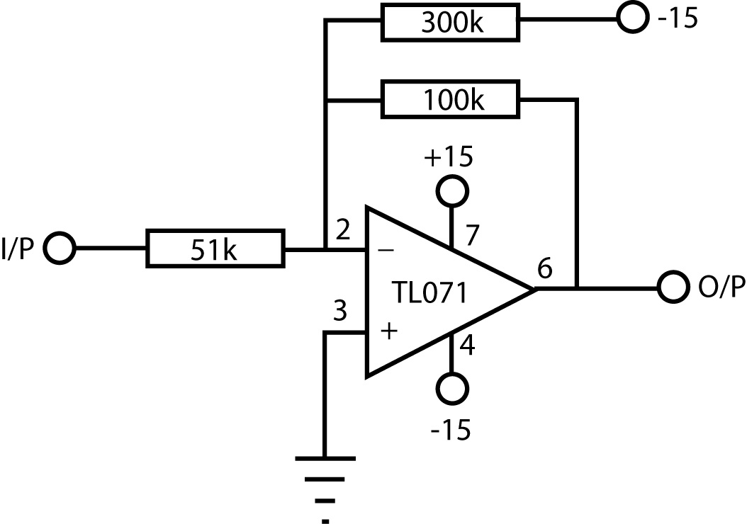

I built this double VCO board too and, after the usual troubleshooting (I ALWAYS make some mistakes), it works perfectly.
The RingMod output has a strong DC offset in mine too, but from the schematic I would say it's just designed to be so, not an error or a building mistake.
I don't remember the exact amount of DC offset; your '6V to 12V' may well be right. I can measure it tonight and report tomorrow if you like.
All outputs are positive-only; I added output level shifters, but forgot to level-shift this ringmod output, oops!
I modified the board a little in order to have sync input, sync output and LFO option in both oscillators, so that they are now an identical pair; it was easy and worked fine.
This board is just GREAT, tracks well and sounds gorgeous. I am very happy with it. Thank you Andy, thank you ARP, thank you electro.music forum ! |

Joined: Apr 27, 2007 Posts: 564 Location: Argentina
Posted: Mon Jan 09, 2012 8:42 am Post subject:
Hi Jaba:
Thanks for your reply.
I did level shifters for the output too, and when doing them I discover the DC level of the RingMod out.
If that is a normal behaviour, I just made the level shifter according to that, just want to be sure I didn't make a mistake.
Thank you.

Do you have schematics for the level shifters? I'd be very interested in seeing them.
Thank you. |
Jaba
Joined: Feb 27, 2009 Posts: 48 Location: Genova, Italy
Posted: Mon Jan 23, 2012 6:32 am Post subject:
a schematic for a level shifter circuit was already shown in this thread here:
http://electro-music.com/forum/topic-28604-175.html
this is a direct link to the jpg file:
http://electro-music.com/forum/download.php?id=15822
but if you really want your output to be exactly -5V to +5V, then you'll have to change the resistors' values a bit depending on the actual values of your signals, and maybe on your OpAmps offset error too.
I believe that the values shown were intended for converting a 0 to +5V signal into a -5V to +5V one. |
LetterBeacon
Joined: Mar 18, 2008 Posts: 454 Location: London, UK
Posted: Thu Jan 26, 2012 5:05 am Post subject:
Ah yes, I'd seen that before. I think I started a layout for that a while back.
Did you use four TL071 for each output or just one TL074? |

Posted: Fri Jan 27, 2012 10:20 am Post subject:
I used a similar circuit, but used an inverter before each level shifter, for some reason I'm feel better knowing that the outputs have the original phase. _________________ Sebo
