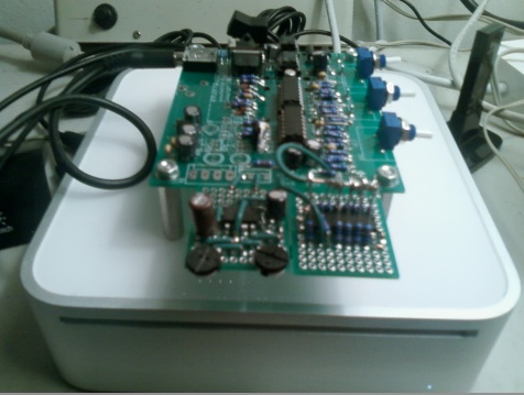

Here is a micro-Lunetta that I made today. You can see the Karplus Strong circuit board on standoffs atop the Mac mini. On the front are two of those little eChucK Lunetta boards I had made.
The left is a 555 oscillator with pulse width and note frequency control, and on the right is a CD4040 binary counter. The outputs of the counter are combined with 100kOhm resistors to create a control voltage input for the KS board.
It's sort of a minimal Boolean Sequencer, requiring only two chips to make a fixed song of 4096 steps length. There are 13 unique tones produced with a binary counting effect to the music. This board was constructed by me for a customer so i will be sad to see it go lol.

droffset - great concept - I like that... ('specially all the blinkin lights)
Les - I'd like to hear what that module does....

Joined: Oct 13, 2007
Posts: 6221
Audio files: 267
PostPosted: Thu Mar 18, 2010 12:34 pm    Post subject: Reply with quote  Mark this post and the followings unread
electri-fire wrote:
Ooh nice Les, I wonder who it's for, hehe. Me maybe?
Hehe, yes, this one is for you Mathe.
Bruce: See if you can catch my show tonight, I'll be playing the module then.
Les
