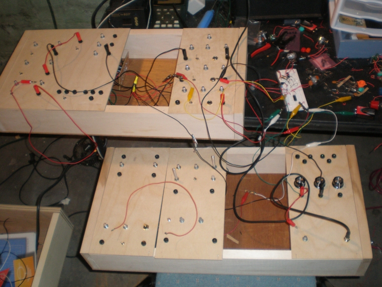

Been lurking awhile. Figured I should start participating since I've gotten so many great ideas/schematics from this forum.
Here is my work in progress. It's sort of a mutant Lunetta, as its not strictly CMOS (hope everyone can forgive me). I decided to do banks of similar modules (filters with filters, dividers with dividers, etc), rather than separate face plates for each module.
So, from top to bottom, left to right:
- 3x 40106 LFO/clocks
- Pulse width divider (one input, 3 outs)
- 4040 divider
- 3x 40106 audio range oscillators (with power starve, inputs for FM, and a jack for external pitch control)
- 2x passive tone controllers
- WSG VCF
- Circuit bent Barbie echo
- Getlofi.com delay kit
- 2x 2-to-1/1-to-2
- Passive mixer with output volume control
I have more info on it at my blog (www.learningtosynth.blogspot.com) with links to where the schematics came from.
(Excuse the mess in the picture, one my cats got into my shop the other day and knocked a bunch of stuff over.)

Looking good man! I like the wood.

Are you going to stain the case. I like wood lunettas. Very Happy Very Happy
You call that a mess, you neatfreak? Embarassed An elephant must have knocked my stuff over then. Laughing

Not sure what I'm going to do. I'm currently fighting the urge to build a larger case for it... IT NEVER ENDS!

What you can't see in the picture are my ICs scattered all over the floor. Oh, cats... And thanks Smile
