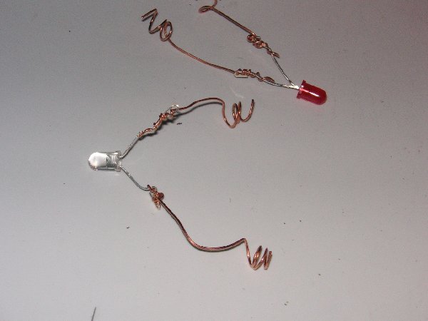

Here's another small progress video. Testing out led gating on some of the outputs by coiling some copper wire on the ends of my leds. They connect to the bolts super easy and add a little light show to my lunetta.
Zontar Prevails!

fantastic, the leds make a real difference.
Do you have a xor in there? It's really great for smashing those squarewaves and creating some unusual sounds.

Why yes I do have an XOR in there somewhere Very Happy . So many patches to try and not enough time or alligator clips Wink . Next time I get into the utility room (I mean mad scientist's lab), I'll try out my XORS.
I'm enjoying the patchable leds too. Time to raid the Christmas lights box in the garage!

Thanks guys. 'Space Crickets' is now the working title of that piece. Wink
If memory serves me correctly: The patching involves 3 40106 oscillators. 1 going into my 4040, another to a 4025 Triple Input NOR, and another going into my 4093 NAND. Various outs from the 4040 connect to the ins of the 4093 and 4025, then to my r/2r and then the YAVCO, then my mixer. There’s a couple of leds added to the outs, which adds another layer of gating. I didn't have any alligator clips left so I called it done.
And yes, I’d prefer my lil' one twisting oscillators than the crappy electronics they put in every baby device. I’m already having a hard time keeping my 5 year old boy from “adjusting” my well planned out settings! Laughing
Captured alien crickets. Pretty quiet when not feeding on my lunetta...

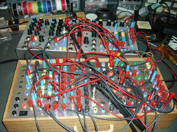

PostPosted: Fri Aug 13, 2010 7:16 am    Post subject: Reply with quote  Mark this post and the followings unread
Some of you have heard this...
I tricked my Lunetta into playing with the Thomas Henry Quad Bass++ Smile
This patch is self-playing, although I manipulated the mixer at the beginning and end to bring in the Lunetta voices and fade them out.

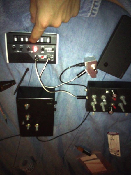

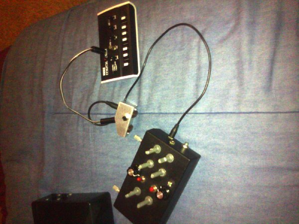

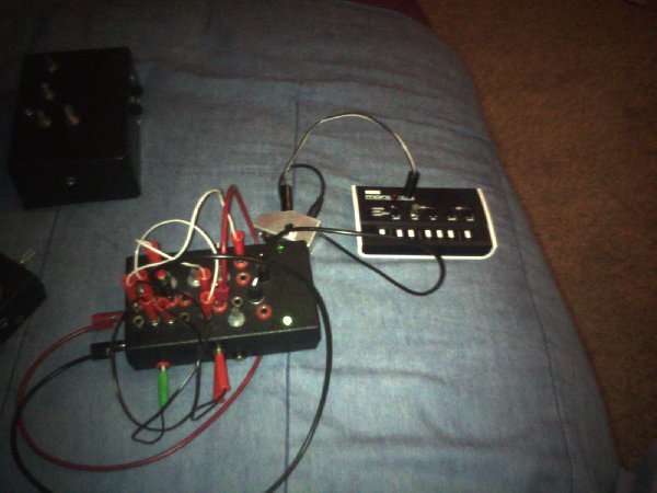

PostPosted: Sat Aug 14, 2010 10:32 pm    Post subject: my lunetta and monotron setups Reply with quote  Mark this post and the followings unread
cutoff cv input
 Filesize:  405.49 KB
 Viewed:  183 Time(s)
cutoff cv input
 Filesize:  301.85 KB
 Viewed:  188 Time(s)
cutoff and pitch cv input
 Filesize:  318.17 KB
 Viewed:  196 Time(s)
