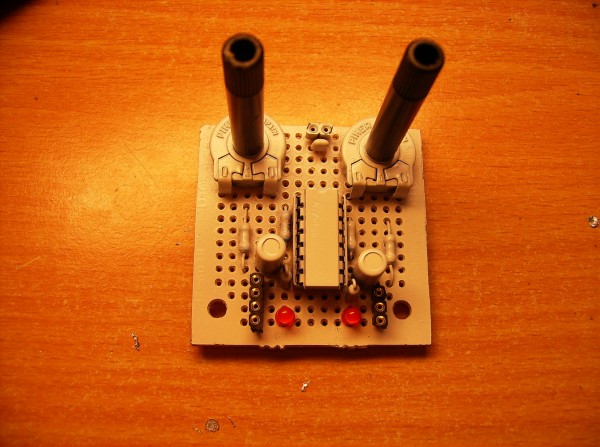

PostPosted: Sat Sep 24, 2011 4:21 am    Post subject: Reply with quote  Mark this post and the followings unread
, painting breadboards isn't a problem ? I suppose you do that before soldering, so, does paint goes to the other side ? Do you have a trick ?
I have been using a permanent marker for all my perfboard projects, doesn't clog up the holes and you get a nice shiny finish.
Another approach is to solder in all the parts that are not visually important, spray paint the entire board and then add things like led's, knobs, headers and switches. Like this:

yeah, this is cool !
thanks for all your answers, guy !
i'll go for it, soon !
i think i'll have finished my first lunetta module next monday, so... i'll send you a pic of it.
ps : your pots, tjookum seem to be good stuff, could you tell me where you buy them ? Actually i work with mini alps pots, but they don't fit in the protoboard, i mean i can only solder the three main lug...

PostPosted: Sat Sep 24, 2011 1:45 pm    Post subject: Reply with quote  Mark this post and the followings unread
They feel and look pretty fragile but my first ever module, a quad oscillator still works just fine after more than a year. .They are piher PT15, most suppliers sell the shaft seperately and they also come with a thumbwheel.
I use them for quick prototypes and they are great when working on perfboard but for a finished device I would definately use real metal potentiometers
Im still looking for a supplier who sells these in different values:http://www.adafruit.com/images/medium/bbtrimpot10K_MED.jpg

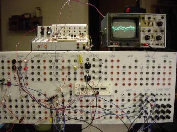

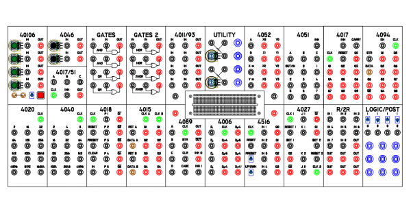

PostPosted: Sun Oct 16, 2011 10:55 am    Post subject: First Lunetta
Subject description: a photo
I've been lurking here awhile. Found lots of useful information, and this is what I came up with. I couldn't have done it without your help. Thanks!
 Filesize:  1.39 MB
 Viewed:  409 Time(s)
 Filesize:  253.37 KB
 Viewed:  539 Time(s)
Posts: 24482
PostPosted: Sun Oct 16, 2011 11:00 am    Post subject: Re: First Lunetta
nice! and welcome :-)

PostPosted: Sun Oct 16, 2011 9:50 pm    Post subject: Re: First Lunetta
Wow, that looks pretty nice. How did you make the panel? Is it acrylic?

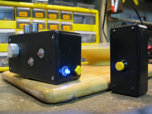

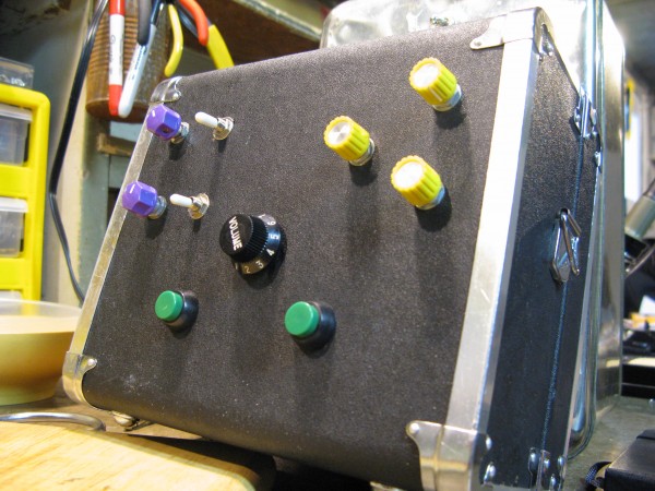

Here's some pics and sound files, DIY amplified by a 9V battery in a tin shoebox, recorded with the built in mic on my laptop for optimum hi-fi standards. I ran out of time for drawing up the schematics before going out of town for a long time, so it might be a few months before I get those up here. They're basically common internet DIY community schematics and designs, modded to fit the gig.
I've really been digging Johannessy's and jcintheus' posts, bravo!
for the whale float
 Filesize:  926.96 KB
 Viewed:  243 Time(s)
for the pac-man-like fish float
 Filesize:  1.24 MB
 Viewed:  246 Time(s)
noise arp L.mp3
pac man noise machine
 Filename:  noise arp L.mp3
 Filesize:  1.82 MB
 Downloaded:  816 Time(s)
mouth machine.mp3
the whale float voice, without processing. i drank too much coffee before recording this.
 Filename:  mouth machine.mp3
 Filesize:  869.84 KB
 Downloaded:  825 Time(s)

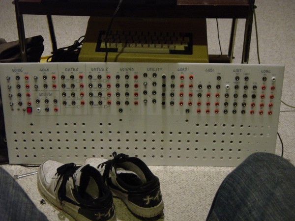

PostPosted: Mon Oct 17, 2011 6:52 am    Post subject: Reply with quote  Mark this post and the followings unread
Thanks! I drafted up the layout in AutoCad, printed it onto paper, taped the paper to the acrylic, drilled the holes, and used the holes to line up the labels. The labels were printed on clear sticker paper for inkjet printers.(not recommended)
here's a work in progress photo
 Filesize:  1.36 MB
 Viewed:  262 Time(s)

PostPosted: Tue Oct 18, 2011 1:51 am    Post subject: Reply with quote  Mark this post and the followings unread
Really like what you've made jcintheus. There are some IC's in there that I have in my stash but never even got a spot on the breadboard.
So the 4020 is basically a 4040 with larger divisions? Thanks, I didn't know that. Wich IC in there do you use most?
And more sounds are always welcome, Im still surprised that some recordings can sound so different while we all work with the same basic components.

PostPosted: Tue Oct 18, 2011 7:23 am    Post subject: Reply with quote  Mark this post and the followings unread
Thanks tjookum. Time will tell which IC I'll use the most, but as of now I really like the 4006. It is a very versatile shift register. Also, the 4052 is starting to see some use.
Edit: after considering your question all day, I decided to try one of the less used IC's, in this case, the 4089. It "multiplies" the clock frequency by multiples of 1/16. But, it does do in an uneven way so as to give interesting rhythms. While noodling around with the connections I stumbled upon some interesting percussion effects!
