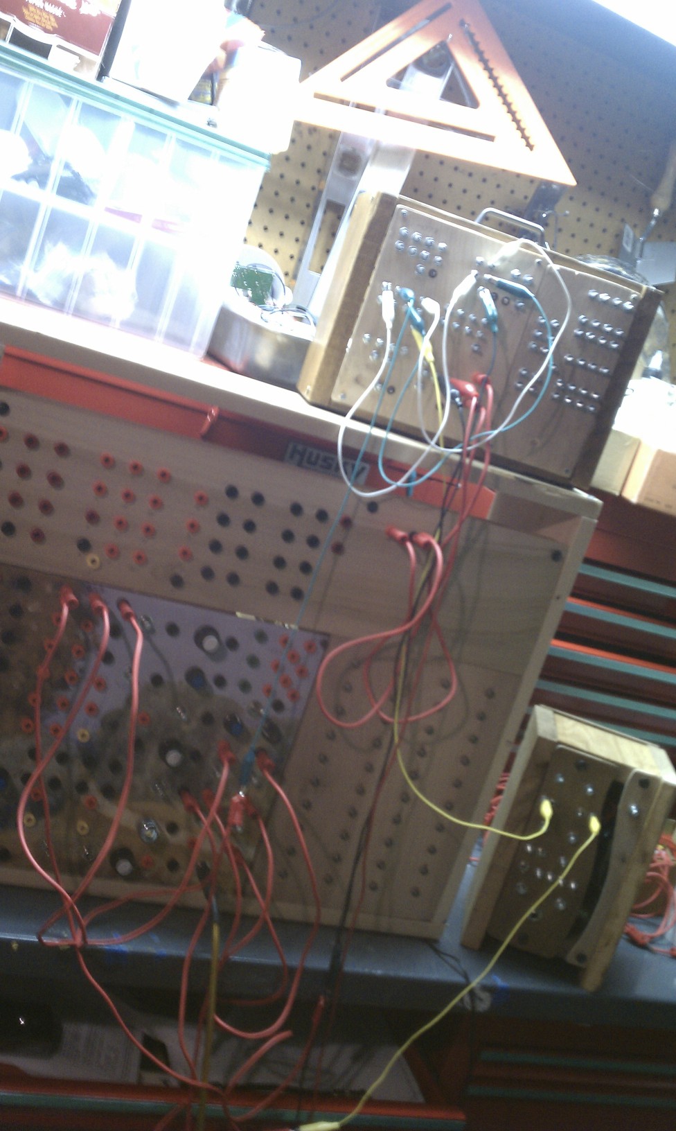

Here's a quick vid of my newest lunetta; I call him Pipboy and he provides a few extra ics for patching. 4078 8 input NOR gate, 4072 4 input OR gate,
4031 brought out to the panel (not as tap looper), two sets of dividers (4040 and 4020), and a 4029 up/down counter.
The 4029 has a 4017's outs patched into its Jam inputs.
Here's my lunetta collection slowly growing:

my baby brother likes the sounds it makes Very Happy

Draal - really nice music coming out of there. Plus, it's good for your kids!
