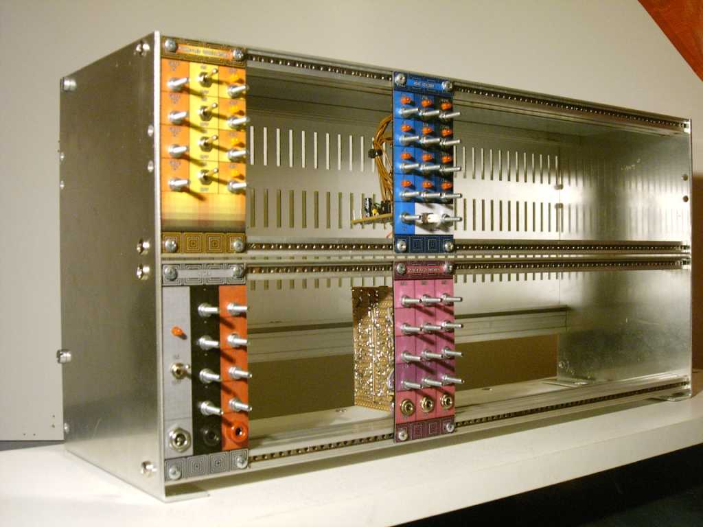

actually, it's quite funny you say that because I did search for a blotter template to use. (didn't find one, didn't want to make one)
I just finished the case, made from a crappy rack case I got a while back. I turned it around facing front down,
flipped the sides so those mounting 'ears' are facing inwards, moved the existing rails and added 2 extra.
It's not what I originally had in mind, which was 3 modules high, not as wide and made of wood,
but I'm happy with it Razz
I probably should record some sounds, maybe I'll do that later tonight and post some more info on the modules.
modular lunetta: case

Anyway, looks good what you have come up with. Hope the panels are double dipped. Look forward to some patching done with your tongue. Laughing

yes, I know erowid,. some really great designs there (might use some for a future front), but no blank ones.
Challenge accepted! Cool (not gonna use a wallwart when I do that, and have to figure out a way to record it)
might actually be interesting, reminds me of a circuit I saw some years ago. an oscillator made with a
CMOS chip (4049?), which I think had some touchplates or something you had to put on your head.
similar to those LED glasses and binaural beats. Can't seem to find it now.

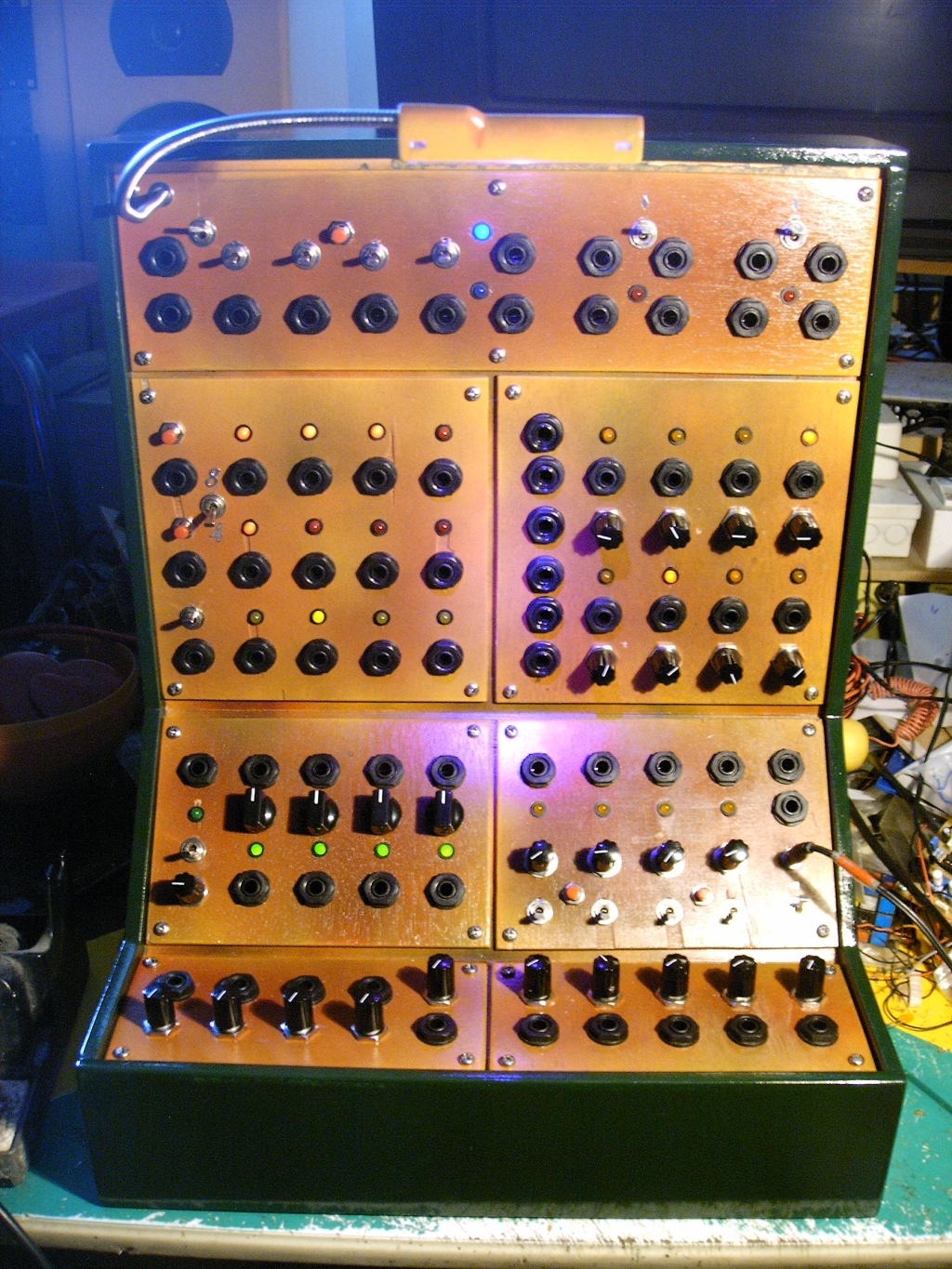

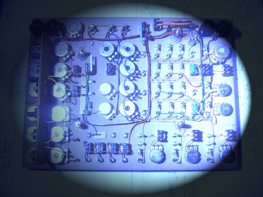

I've been slowly building another lunetta over the past few weeks. I sneak in a few minutes when I can to get her done. Minimal expense and recycling are the themes here.
This one is called Mastodon and is being constructed in a bare bones, scrap heap post nuclear manner. Anything that can be drilled and screwed can be a useful panel it it ain't TOO flimsy.
5 Oscillators (3 with cap switches)
passive 4 input mixer with Tone control
1 4040
1 4020
1 4051
1 4046 pitch tracker with cap switches
1 4031 brought out to the panel
1 4029 counter
And some goofy gates (8 input, dual 4 input or gates) can't remember thedetails Rolling Eyes
I'm not done but here's some pics:
Pitch tracker "panel"

Got the kid doing your soldering work yet? Smile.

You are a very disturbed individual. Don't ever change Smile

Mastodon Specs:
5 oscillators from 1 40106 - some with Hi/Low switches
cd4072 Dual 4 input OR Gate
cd4078 8 input NOR Gate
cd4040 Divider
cd4051Multiplexor
cd4020 Divider
cd4029 Up/Down Counter
cd4031
4046 as pitch tracker w/switches for small or big caps
4046 as simple vco
4 input active mixer
The Junk Drawer Lunetta is just about there in terms of soldering. There's always that feeling of, "Just one more idea". But I think I'll take a break from the smoke and explore the sonic possibilities.

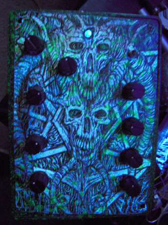

Murderbox 1 two 556 atari punks into a 741 mixer

Nice artwork Very Happy . Giger would be proud.
