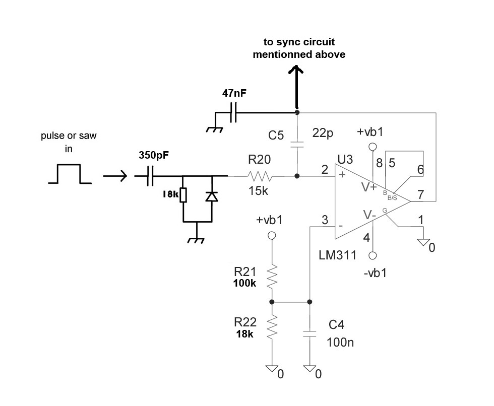

PostPosted: Thu Jan 31, 2013 6:21 am    Post subject: Reply with quote  Mark this post and the followings unread
I am also about to finish the great sounding Living VCOs and I would like to add that Hard Sync feature.
My knowledge level is limited, but I am trying to improve day by day.
Here is my drawing... it would be great if anybody can confirm:
Thank you! Smile
regards,
Marc
saint gillis
Joined: Apr 21, 2012
Posts: 60
Location: Brussels
PostPosted: Wed Feb 13, 2013 3:35 am    Post subject: Reply with quote  Mark this post and the followings unread
Hello Marc!
I don't have an original PCB made by the great Jurgen himself so I can't check myself if everything is correct, but it looks like there is a mistake where I ve put a red cross :
This part of the additional circuit should be connected on R20 resistor as you can see here (not on IC3's pin2) :

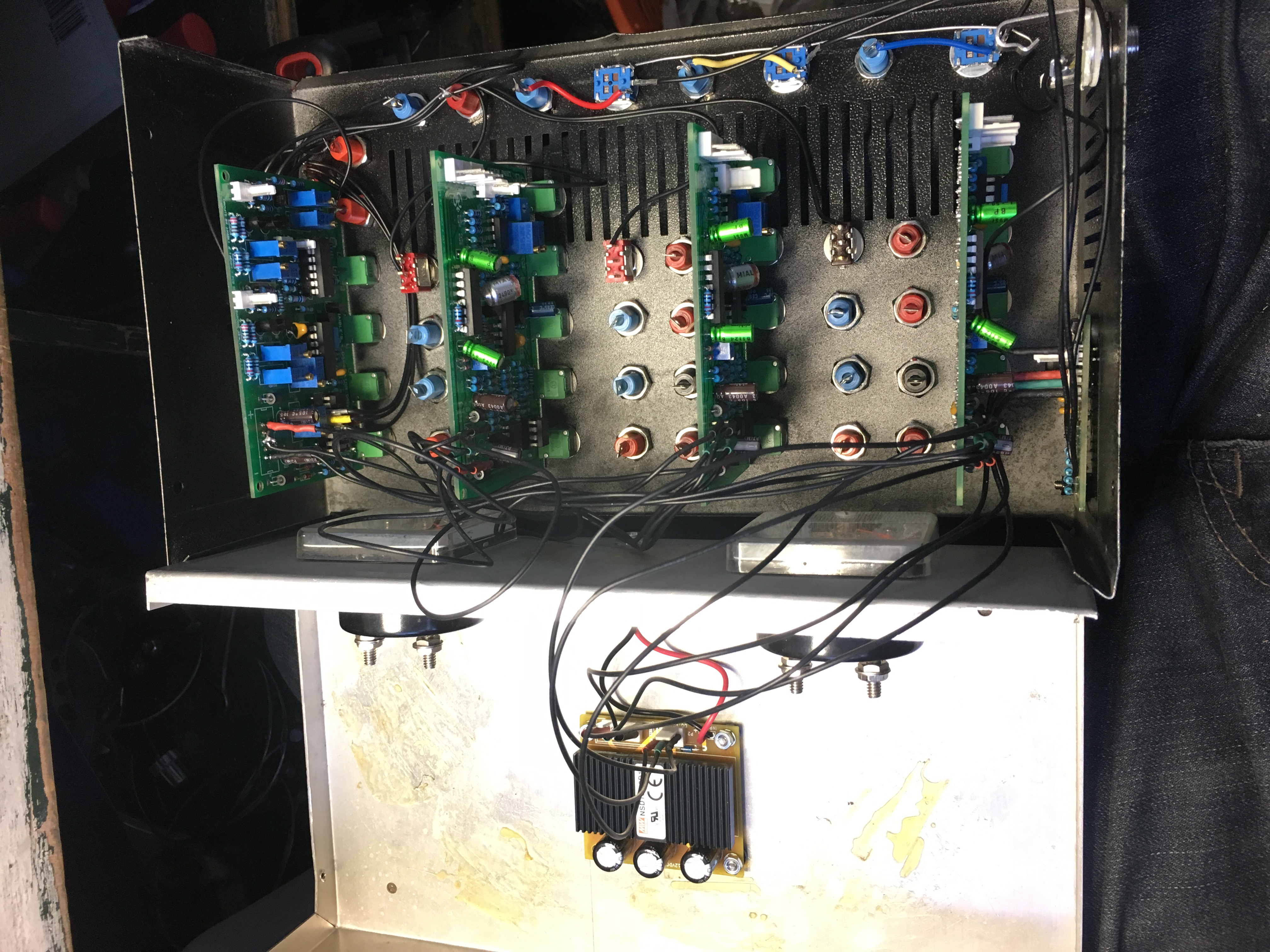

PostPosted: Thu Oct 11, 2018 5:46 am    Post subject: Reply with quote  Mark this post and the followings unread
I'm in need of a little help with a Living VCO's build.
I made a standalone box using 3 of the Logicgate 2014 Barcode edition 1.3 Core PCB's and one of the Logicgate / Thomas Henry 2014 V1.1 Driver PCB's. I think these pcbs were original meant for a Euro build, which I'm not interested in. I need a standalone, easily transportable performance box
I'm finding it very difficult to find any pictures of the bare PCB's as I forgot to match resistors.
Also, I'm finding it impossible to find any calibration specifically for this set of PCB's. I know that some of the function will relate to the original calibration instructions but I'm wondering if anyone has built with these PCB's.
 Filesize:  2.55 MB
