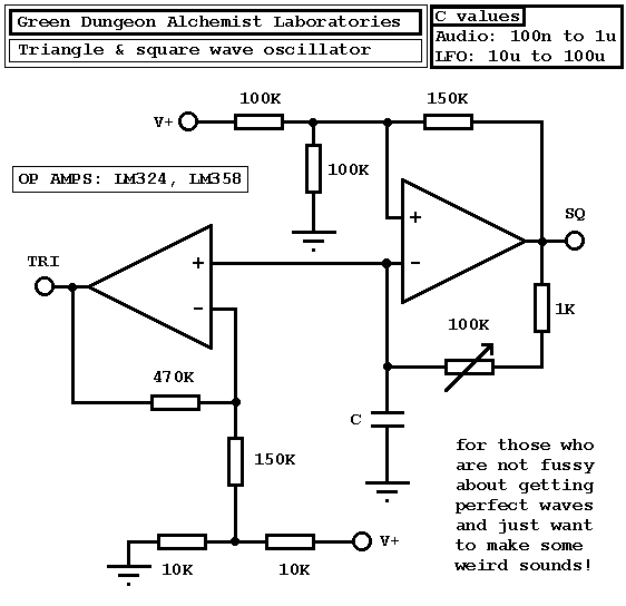

PostPosted: Mon Dec 23, 2013 3:33 pm    Post subject: Reply with quote  Mark this post and the followings unread
I couldn't find the original schematic but I could pretty much remember everything, so I drew up another one.
There is another LFO of mine somewhere on this forum, but it's a simple 555 timer based thing, uses more parts than this one!
this one is, as it says, optimized for single supply operation.
Forgot to add: +V is 12V
 Filesize:  4.4 KB
 Viewed:  22788 Time(s)

you might want to try a buffered virtual ground, its more stable
http://www.schematica.com/active_filter_resources/op_amp_virtual_ground_circuits.html
scroll down to "buffered resistor divider" the "output" on the far right of the schematic should connect to your "VGND"

Forgive my ignorance but why on magic smokes 8K LFO is there a 4.7k resistor to ground before the Square output, but on the Tri out it's 10K??
