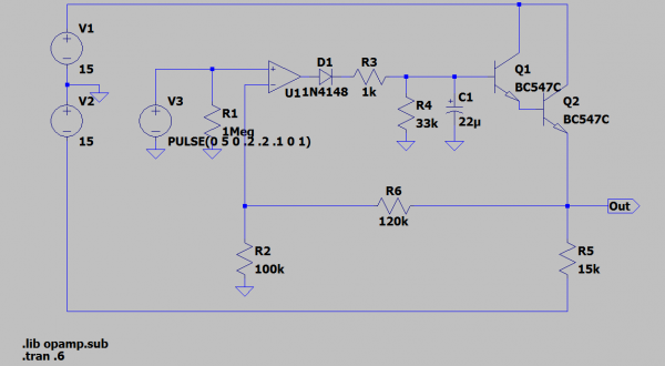

PostPosted: Wed Feb 20, 2019 6:47 am    Post subject: envelope follower Reply with quote  Mark this post and the followings unread
I don't know how many SOST have been built over the years. I just finished building one and I found that the ENV- follower was not working properly. It was more like a comparator with no threshold.
According to LTSpice changing R61 from 1K to 100K makes it much better. Will check that in the module soon.
PostPosted: Mon Feb 25, 2019 2:50 am    Post subject: Reply with quote  Mark this post and the followings unread
I checked everything in real life now.
R61 must be changed from 1K to 100K to make the envelope follower work properly. With 1K it works more or less like a comparator, holding the inverting input of the OpAmp at almost 0V.
Accordingly one has to change R5 from 470K to 100K to have a decent impact onthe modulation.

Boerge
Joined: Sep 02, 2009
Posts: 82
PostPosted: Tue Feb 26, 2019 5:59 am    Post subject: Reply with quote  Mark this post and the followings unread
Just compared the schematics of SoST-Flanger with the original StormTideFlanger - Jürgen used the same Envelopefollower back then. So he made the same mistake twice?
Made a short simulation too. I'm not shure, if I coult trust LTSpice, as it says 140Volts on output, by +/-15V as power supply...
Scematic of my simulation, with the corrected resistor

PostPosted: Tue Feb 26, 2019 6:36 am    Post subject: Reply with quote  Mark this post and the followings unread
It obviously is a mistake. The R61 (R2 in your simulation) has to be in the 100K ballpark, not just 1K.

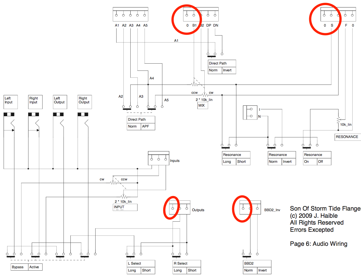

PostPosted: Mon Mar 22, 2021 5:37 am    Post subject: 50/100Hz hum problem Reply with quote  Mark this post and the followings unread
Hi! I build the SOST flanger and it sounds pretty fantastic. Some small debugging here and there but getting there. I do have one bigger problem I don't know how to solve. I have a 50/100 Hz hum.
The hum is always there (whenever the effect is on). But it get's stronger when the signal gets stronger. Here's a little audio example (https://www.dropbox.com/s/1tpejxf6muxz0ue/SOST%2050%3A100%20Hz%20problem.wav?dl=0). You hear it reacting to the volume.
I'm guessing it has something to do with grounding or the power supply?? I'm powering it with this power supply set to 15V https://frequencycentral.co.uk/product/fc-power/
I'm a bit short on knowledge here. This was an ambitious build for me. Already quite happy I got this far. Any help would be very much appreciated.
Thanks

PostPosted: Sat Apr 03, 2021 6:38 am    Post subject: Reply with quote  Mark this post and the followings unread
Ok Problem solved. My walmart adapter wasn't supplying enough juice.. Fixed it.
One last thing (in case anybody reads this..)
On the Audio Connections schematic I see these open connections (mostly connected to ground I think.. SEE ATTACHMENT What do I do with these? Nothing? And if yes.. Why are they there.. I currently leave them empty and everything seems to work.. But just wanna double check..
Thanks

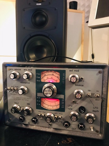

At least almost.. I'm getting some weird noise when the BBD2 switch is on "normal"mode. I made little recording. Just a simple sine wave into the flanger. I'm witching it from normal to inv. Pretty obvious.. Does anybody know what this could be.
https://www.dropbox.com/s/xa4nvuofrcqdg6p/flanger%20noise_MIXDOWN.mp3?dl=0
Apart from that it works amazing. And I'm super happy!

Posts: 24519
PostPosted: Thu Apr 08, 2021 6:37 am    Post subject: Reply with quote  Mark this post and the followings unread
wrentema wrote:
Done!
Nice build!
In the recording I hear clicks .. that probably is the mode switching, and then in one of the two modes there is some distortion ... or actually on better listening it seems to be there in both modes, just a bit softer in one mode ..
Does this also happen when you use a lower input signal? It sounds a bit like it could be clipping somewhere?

PostPosted: Thu Apr 08, 2021 6:55 am    Post subject: Reply with quote  Mark this post and the followings unread
wrentema wrote:
Done!
Nice build!
Yes it's me switching. It's not so much the distortion (clipping). But that obvious "sizzle electrical noise" sound that comes in and out.. It has nothing to do with input volume it seems.
Hmm I probably need to dive into the schematic whenever I have time (WHY DID NOBODY TELL ME DIY IS SOOO TIME CONSUMING:-)).. Maybe it's an IC?
